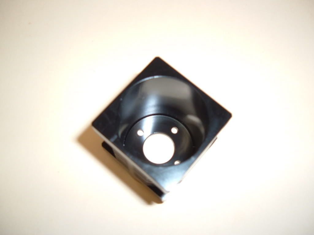

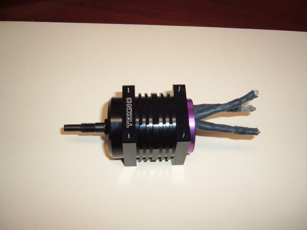

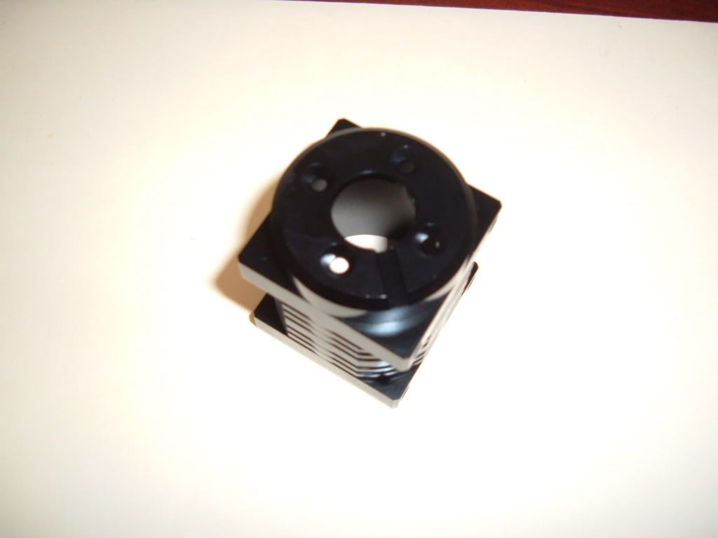

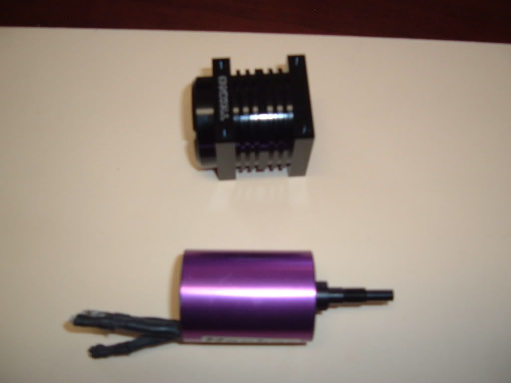

Got the motor mount today from impakt. The CC motor will not work as it has small screws that hold the endbells on, and they stick out the sides, effectively making the motor larger than 36mm in diameter. I tried a few feigao and hacker motors and they fit fine, will try out my 2500kv aveox and see how it does. If it fits I will run it on 4s lipo, instead of 2s with the cc 5700. Still need to mock up the chassis, and build the clutch.

Those mounts look very nice, I definitely want to keep them in mind for the future.

So I mocked the car up with the tekno mount, and it does not allow enough clearance between the side of the mount and the brake disk. Need to be able to move it over about 1/4 inch to get the gears to mesh.
Also, it raises the motor too high, making the clutch contact with the plastic "bridge" that is attached to the front tranny bulk. So it looks like I will be making my own mount, and using the 5700 motor after all. The tekno mount is nice, and I am sure that i will find another use for it.
I still intend to use the tekno clutch adapter and the stock clutch assembly. My motor mount must allow the motor to sit directly on the chassis, for clearance of the clutch. I will most likely use an l bracket mount that has the center of the base removed so that the motor can sit as low as possible. I will tap it to accept the stock nitro mount screws, and adjust it via the slots on the chassis.
