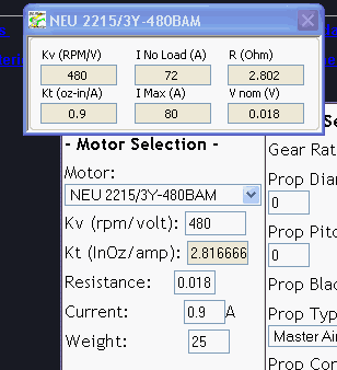

08.12.2008, 11:56 AM
Originally Posted by GriffinRU View Post
I will disagree,
Maximum current is at stand still or lowest RPM not at max RPM. You will never see 55A at 60000RPM with 1515/1y running at 27V.
Maximum current for Neu 1515/1y is 110A
Running current with rated load should be around 40-55Amps.
Better picture can be obtained from motorcalc or my program.
I can publish rated current for all motors if required.
The Kt in your program for the 2215 series is opposite. It should be:
Kt (InOz/amp):
2215/1Y- 0.938
2215/1.5Y- 1.325
2215/2Y- 1.802
2215/2.5Y- 2.253
2215/3Y- 2.816
