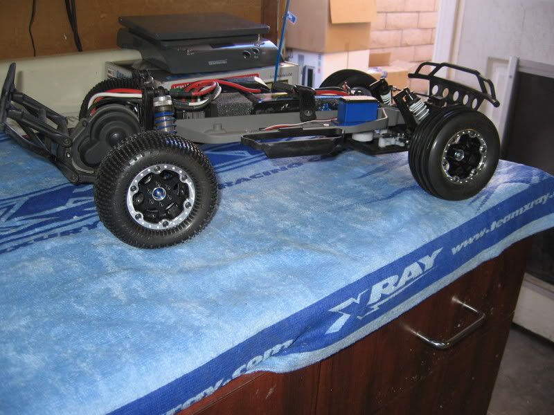

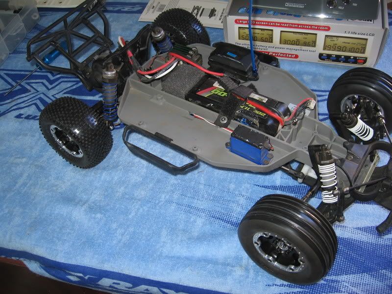

Ok So after listening to everybody about how I need to adjust / better my driving style and remove the locked diff, her is what I have now..
First of all YOU WERE RIGHTE!!! The unlocking of the diff made a huge difference!! I also swapped out the front sway bar for a lighter 808 bar, messed with the toe in / out and relaxed the old trigger finger.. LOL..

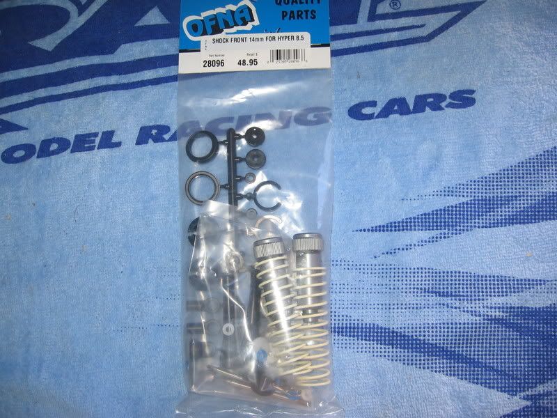

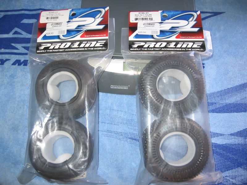

At that point I realized that my Pro-line Flat Irons are worthless (rock crawler tires) so I went out and got some proper tires. I'm now running bowties in the rear and Edge tires in the front. I also received my front Hyper 8.5 shocks for the front shock swap over (tonight’s project).

Could you adjust the rear? it looks like its got some nice toe in on the rear in one of the pics (could just be the angle), but the rustler comes with 0deg toe on the rear, and there is no way to adjust it without flm tranny or mods.
