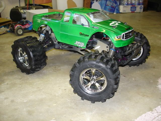

yeah, those shocks are soft for sure.. it make driving much harder.. get a set of the FLM shocktowers and a set of the UE shocks, fill them up with 90-100wt oil and the handling will improve for sure.
dabid
11.19.2005, 12:20 PM
I've already got some kind of funky aftermarket shock towers, no idea who makes them though. I don't have any pics of them yet, but should after today. Here's the closest I've got:
