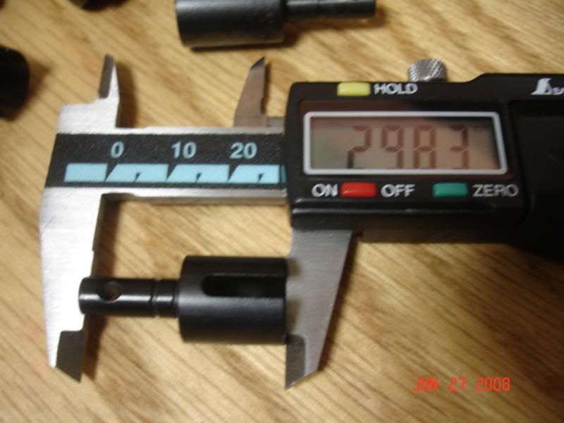

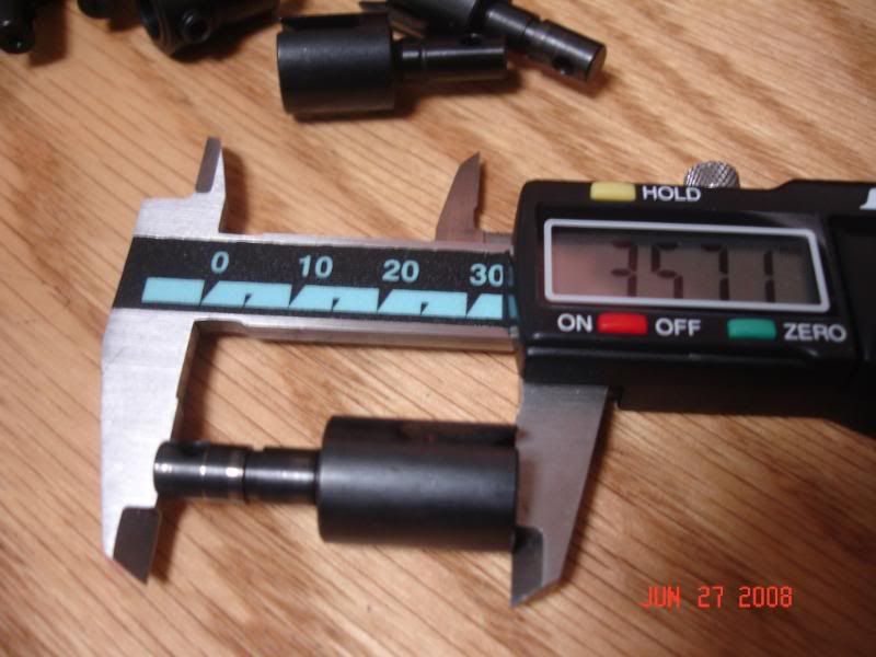

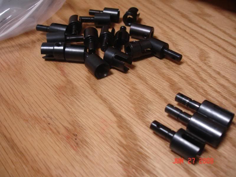

Ofna diff outdrives. I have bunch of these during my experimentation.
Here are some pics:
Ofna hyper 7 diff outdrive:
Ofna mutilator outdrive:
Bunch of them:

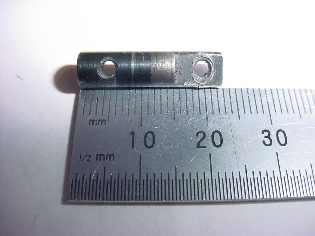

Here's a picture if it helps. It appears to me the THS set might work fine. IIRC, the THS set has 8mm balls.
This shaft is toast. First the hole elongates, then it starts to crack.

The UE ones you just bought works best. I think I have 5 sets those for my diffs. UE does not make them anymore.
I don't have part numbers for the Ofna outdrives. They came with the diffs I bought.
I see you bought them from Scott(Billytrucks).

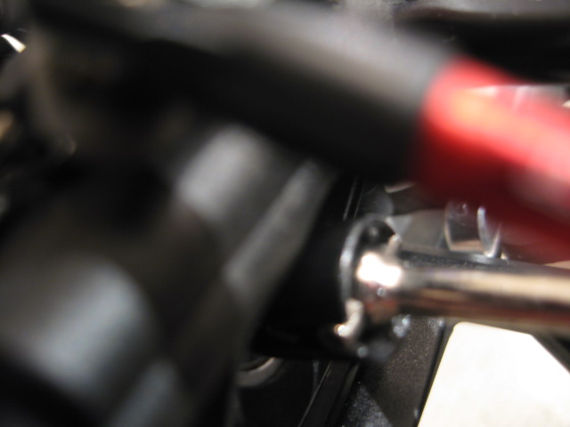

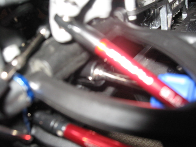

Since I'm waiting for the UE cups to arrive, I decided to install the genuine Hot Bodies Out drive Shafts, just to see how off they were. Dunno if you can see it in the pics
ID:	6644   Click image for larger version
ID:	6645   Click image for larger version
