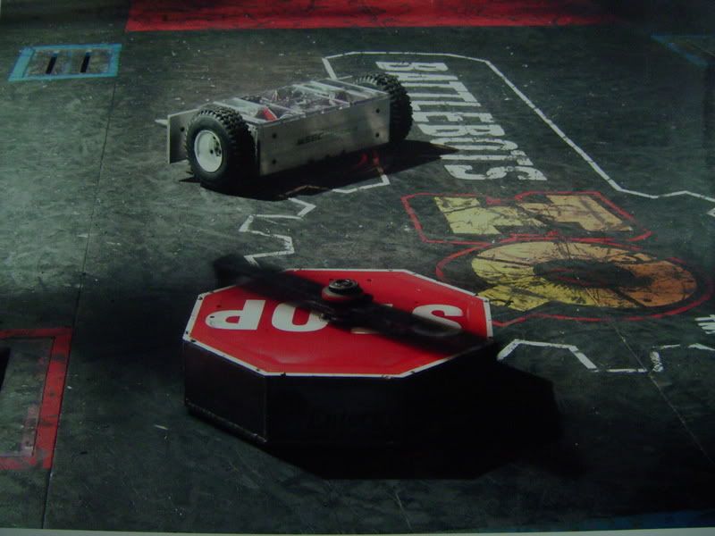

Machined 6061 case, 1/2 steel shaft, 1/4" thick NdFeB magnets and a 4-pole armature! To top it all off, 82% efficiency! I love these things!
I used one back in HS in a Battlebot my shop class built. It spun up a 24 pound steel bar to 2000 RpM (3:1 chain drive) in about a second.
What did you call this spinning bar o' death? The shin basher? Sounds like something fun to chase drunks with... watch out Shaun (tdc57)!!!

It was called "Stop Bot" because we used a 1/4" thick piece of 6061 as the top that was the exact dimensions of a stop sign and painted just like one. It was about 8" tall and the steel bar extended down the sides.
