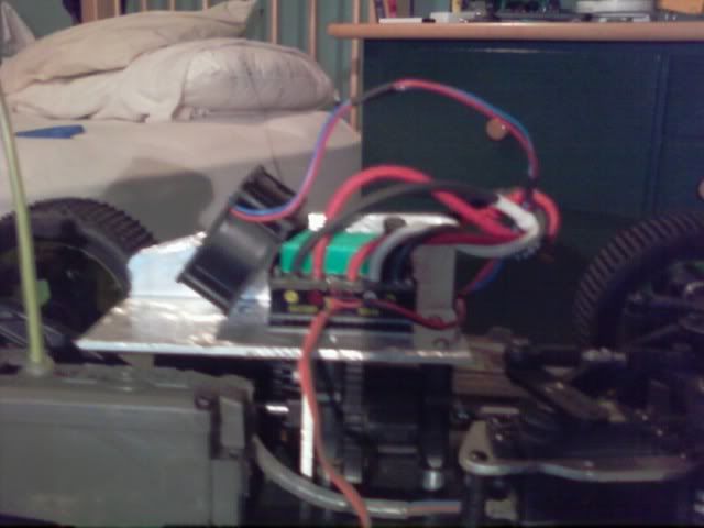

OK, I finally got it all to work, and fit under the body! and it looks neat too. I have the mm sitting under the tall part of the shark fin, with a 40mm fan mounted on a 45degree angle right after it.

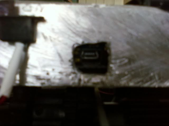

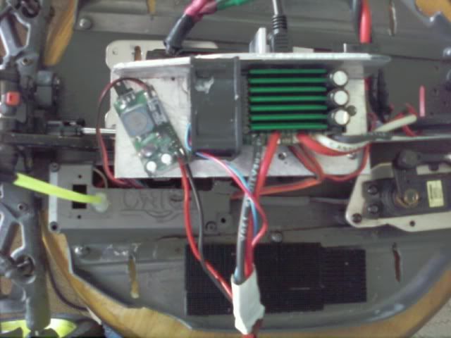

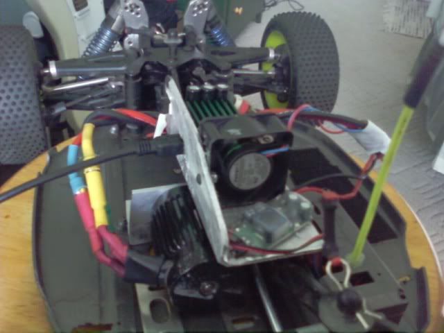

well, I've done some more work on my hyper 7 since last post, and the bash that wasn't supposed to be... I was over ben's and no matter what things just stopped working. First it was the split in the body where the pin hole is, then it was a stripped motor screw, and then it was the spur gear. After that the fm transmitter wouldnt work and then the mamba wouldn't work! I'm guessing most of it was because of the cold, because it all works now that its warm and I replaced the motor screws. The mamba still didnt so I ended up downgrading it to the lowest firmware, then upgraded it to every single firmware upgrade one at a time, then erased all settings, and it worked! but the lvc is still a little bit flaky... I added the BEC that finally came, and WOOHOO i finally have another working soldering iron!!! I mounted the bec on the shark fin, moved the fan and replaced all the hot glue with a 3 mm screw, and added a nice window to the fin so I can access the USB port without the chance of me snapping my mamba in half unvelcro-ing it.(20 lbs of tensile strength holding it down!!!) Now all I am waiting for is the spur gear that is taking like 3 weeks to come from tower hobbies...

Looks great.
Is that BEC adjustable voltage?
eovnu87435ds
A 16yr old with a combover
eovnu87435ds's Avatar
Posts: 636
Location: Mount Holly, NJ
12.02.2008, 08:12 PM
yeah, either 5 or 6v output

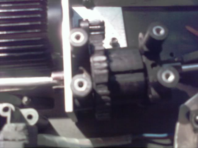

OK my spur gear was officially eaten... glad the steel one is coming!

Oh the joys of a metal spur gear, so ur car sounds like its dragging chains behind it
  (#30)
12.03.2008, 12:43 AM
Yeah, it sounds awful, but preforms well.
