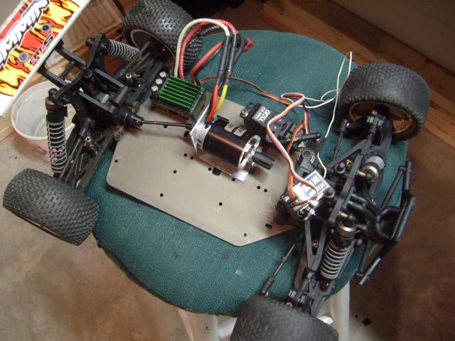

I've got an updated pic. I ended up getting the 1100kv motor. I still need a 3s lipo, a battery tray and a front drive shaft. I also need to do little things like move the motor a little to the middle and get the radio box/antenna mounted.
I tried it out on 8s nimh and it had tons or torque and I got decent speed. I think it's great because I picked the outruner to run on 3-4s lipo.
