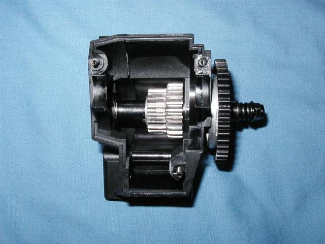

The trans has a new primary gear and a new thicker idler shaft. Hopefully it will hold up well.

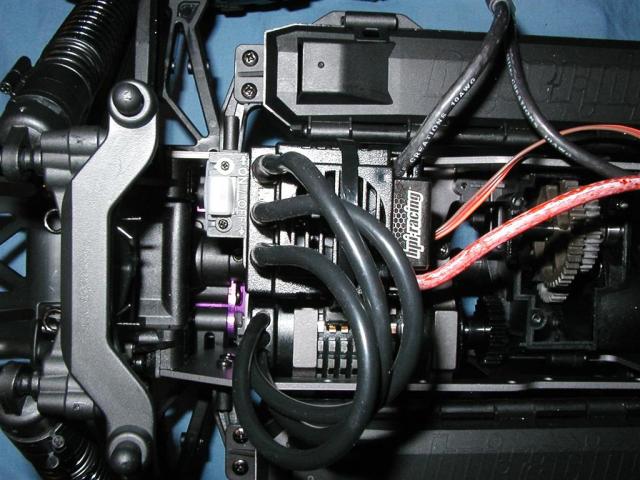

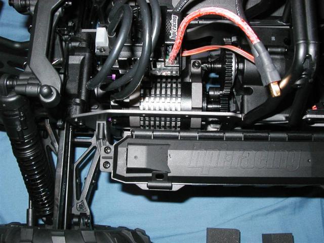

The motor mount is massive! Should clamp great.

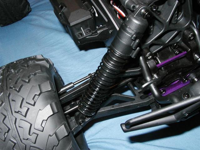

I put on the optional 25 tooth pinion and will run it with two 3S 5000 Flightpowers. I also put on some stiffer springs on the big bore shocks. It comes with the pink spring (medium-soft). I used the white springs (medium-stiff).

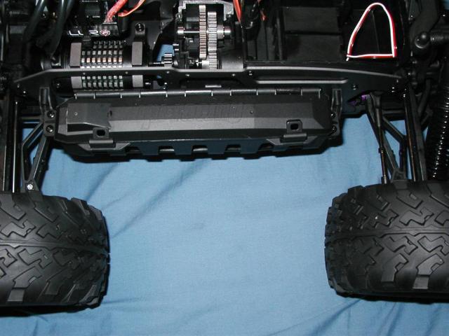

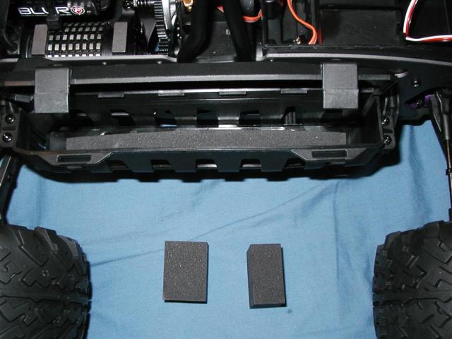

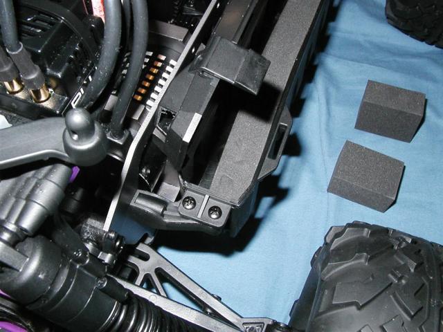

A few more details, the battery boxes are nice! The accessories bag has foam blocks and foam strips to customize the internal size. Box size is 30.4mm x 51.1mm x 201mm. (Rough measurement with calipers).

The ESC mount is held up by the frame on one side and a thick hollow plastic standoff on the other (next to the motor).

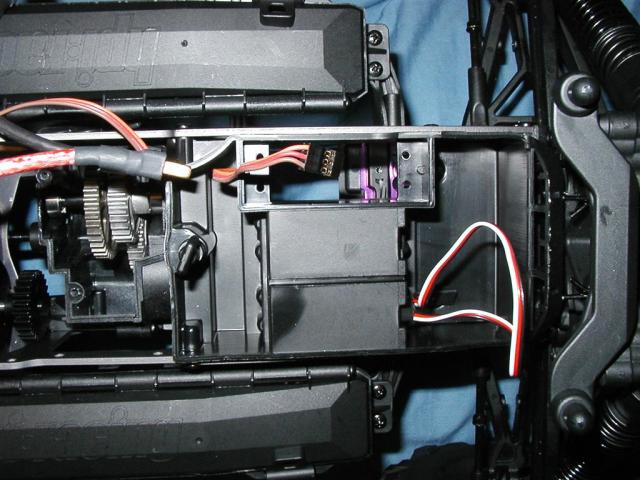

The radio box has a lot of room with no throttle/brake servo or reverse servo. I took out the AM RX and put in a Futaba 2.4GHz system.

Some pictures.

there no grease in the tranny????

How is the ESC on/off switch attached to the ESC?

Nope, no grease in the tranny.
The switch is mounted to the ESC plate. It is completely sealed with a flexible hood. It's the white square in the last picture behind the three motor leads.
