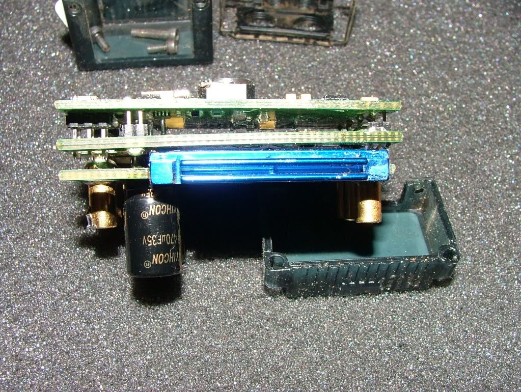

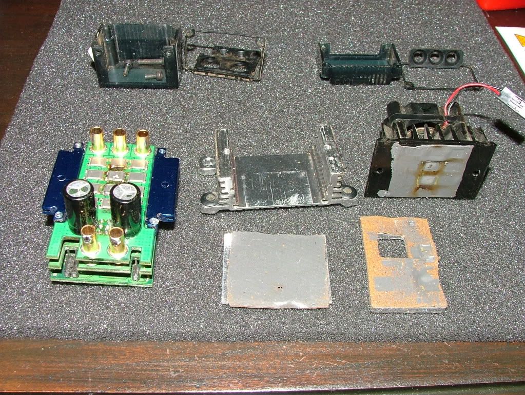

I installed the lastest Firmware Losi released for the 1/8 ESC. The ESC was smoother on takoff and ran fine for a whole pack. Second pack started off good. But it let the magic smoke out when it cogged for second.

I took mine apart and saw the 3 fets with the missing smoke compartments.

For those interested, here are guts of the ESC.
