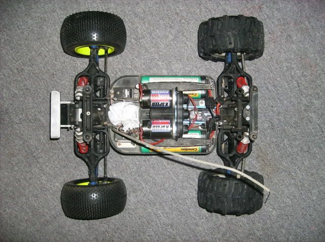

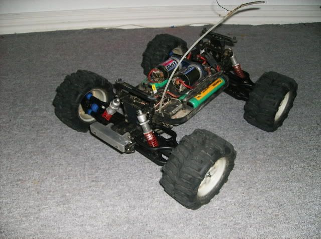

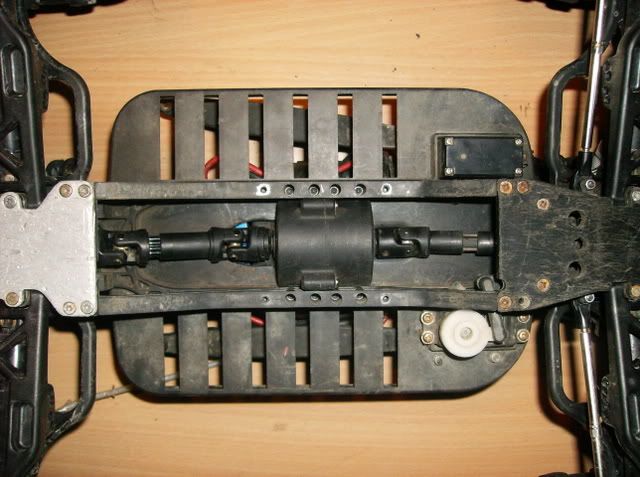

I made a 775 motor mount that centres the motor and I got Mod1 15-16-17T pinions and 49-52-54T spur gears
And I ordered new harder shock springs

Son of a biznatch, thats what I've wanted to build for my whole R/C life- those Icelandic trucks are awesome, always loved the mentalist attitude and driving.
As it is, I'd like to make a cage like that for my Gmaxx chassis, prefer it to a shell really.
Assume work SnoopMaxx, do you have any pics of the new transmission/motor mount, its obscured in those pics?

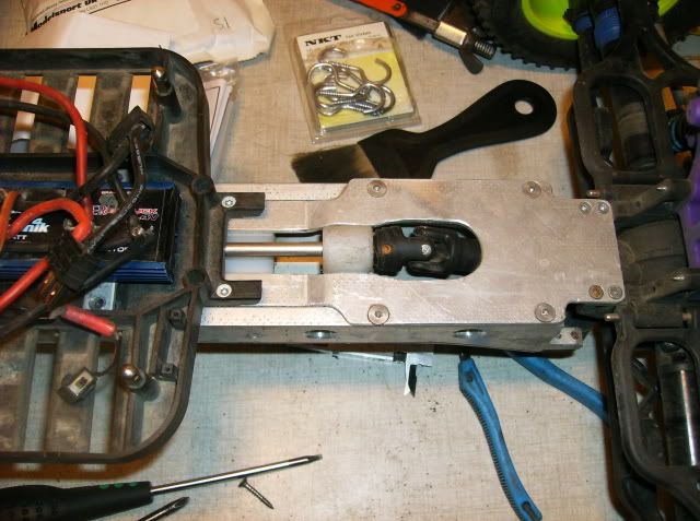

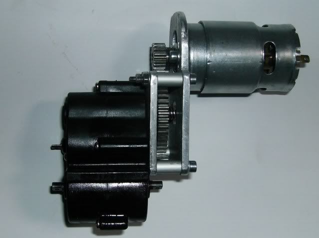

Here is the new motor mount I made
Sorry you will have to wait a little longer

The motor mount in Nightfall
Motor mount in Red Devil
From what I can see they use RCM mounts
And my new Mount for the 775 motor
extended driveshaft made from a piece of 6mm Steel

Clever motor mounts- I've seen stock 3906 motor mounts doubled up to flip the motor around before, but thats only about the second I've seen that centers the motor in the chassis.

The motor mount are designed after the 4:1 reduction gears I made for my Clod Buster
and my Tamiya 3 Speed in 1987-88ish
Itīs just a little bigger

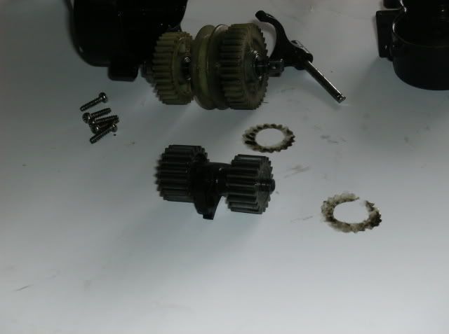

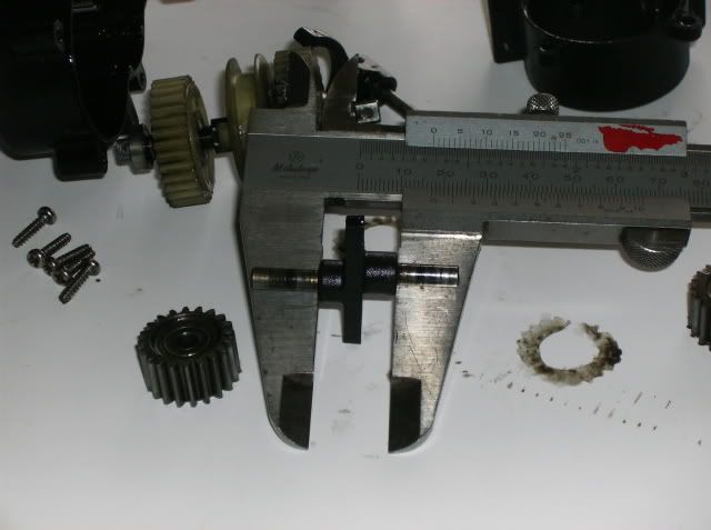

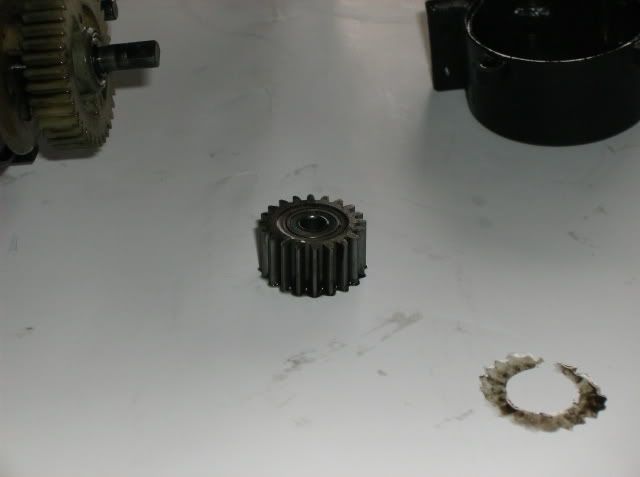

Update on the Tranny modification to mount 3905 steel idler gears in the 3906 tranny
2nd gear Idler is grinded down to 11mm
1st gear idler is 13mm wide, total with on bracket is 38.4mm
Idler shaft bracket is filed down to 17mm so the idler gears can spin freely
