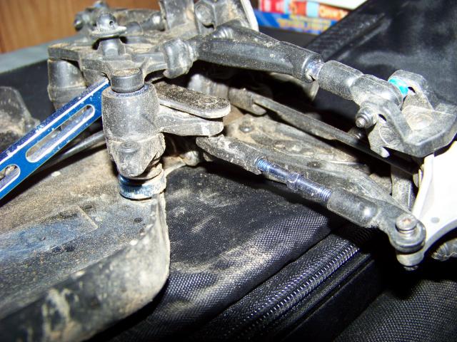

thanks guys for the kind words, yes it is a bit one sided against the nitros. the steering mod didnt give it more steering but got rid of the bump steer and made the steering waaaayyyyyy more consistant all around. use the outside rear hub camber rod insert on both sides of the steering link and mount the inside on the bottom of the bellcrank.
