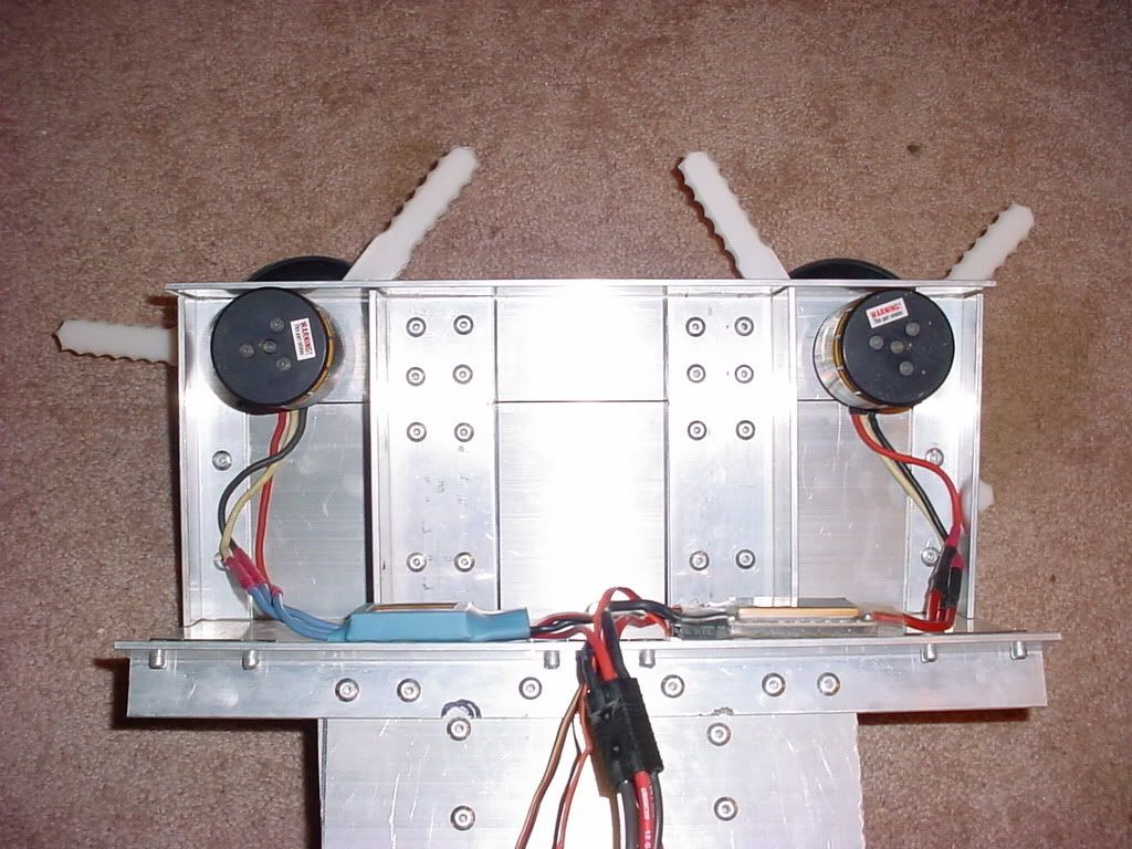

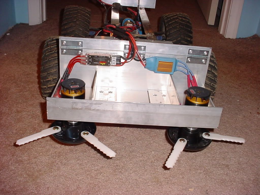

Ok, we have updates.
I got the cutting deck built and installed. Also installed the motors, esc's, and the cutting heads.
The wiring harness is complete. It even works.
The 3rd channel on the radio does successfully turn on and off the cutting deck.
It's still untested, but that will be coming soon.
It appears like housing 20,000mah of Lipo on 4S will be pretty easy.
Here's some pictures.

PS do the blades overlap otherwise you will have a gap in your cut...
Do the blades spin out to stop the grass filling up under the car?

They are currently set to counter rotate outwards, front and center. I'm with you on that line of thinking.
It should help sweep the grass away and to the side, instead of humping it up underneath.

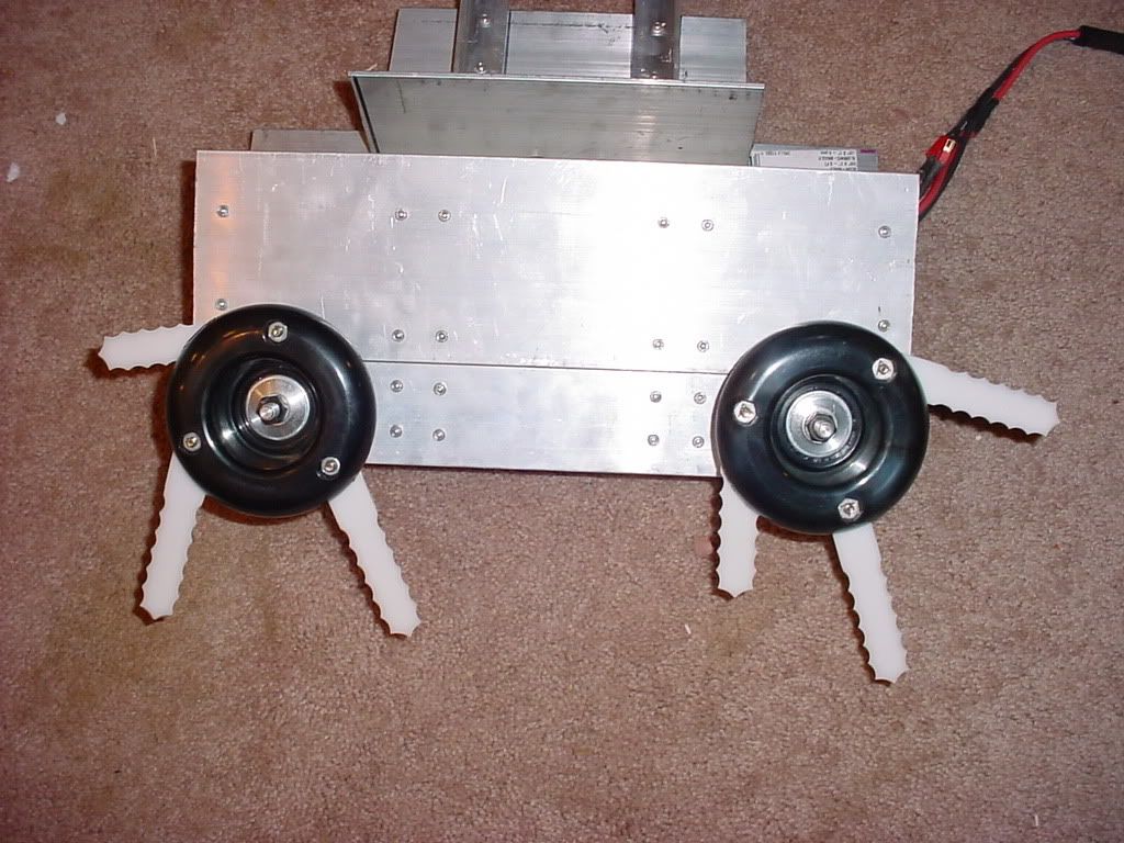

I took the underside picture for you Linc. It shows the prop adapters.
In the pack of goodies that comes with the cutter head, choose a spacer that's too small, then drill the hole to fit the thread.
I also added a large pan washer and a lock washer. If this doesn't hold, I'm thinking Blue Loctite on the threads.
The Prop adapters are aluminum. I wish they were steel. But afterall, they do pull around some really large air planes. There is a fear of over-tightening for me here.
If there is a problem, Red Loctite between the Collet and shaft would lock it down. (And also make things really tough to disassemble)
