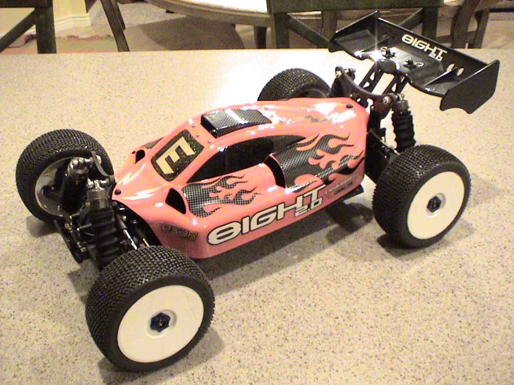

here are some pics of the 8ight now after a couple of weekends at the track. we have had a lot of rain this month so the track has been muddy. i used to hate to get my cars all dirty after putting so much time and money into building a sweet rig. now i dont care. but it is kind of a bitch cleaning them every so often. i like to build them but not really like to maintain them.
