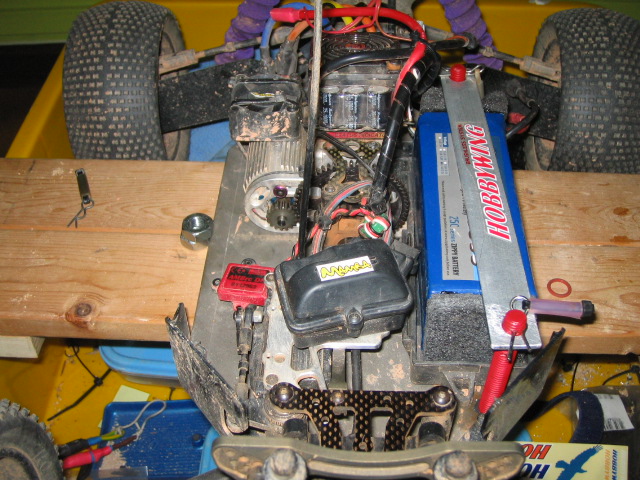

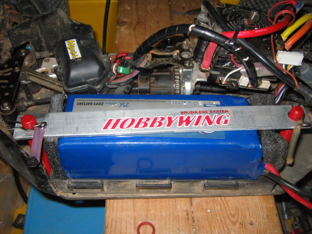

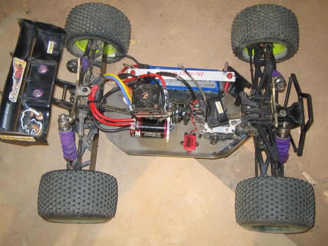

this is my setup n amain videos, i think its slow i m running 6s 5000 with 12pinion medusa 1600kv n 50slip diff on x2 crt.
i was 2nd in 20mins b4 my motor wire got desouldered, its a 25min main(usually 30mins)
its the pinky car with black rims
