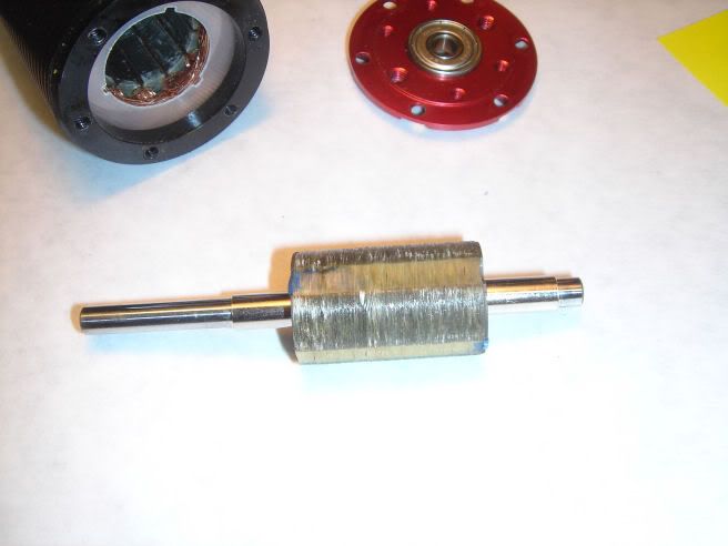

Got my replacement rotor from Tekin, excellent customer support.
This is the separated magnet
Old rotor
New and improved rotor.

Improved? In what way (just curious...) Aside from how it looks...do you know what the change was and why...

In my opinion the use of the large aluminum spacer instead of tubular steel spacer gives the bonding compond/glue more surface area to better hold the magnet to the shaft.
