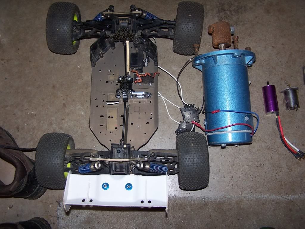

would something like this work?
LOL its only 1/4HP and 900rpm. but its sick!

LOL, nice Kyosho.... but what relevance is that on this topic?

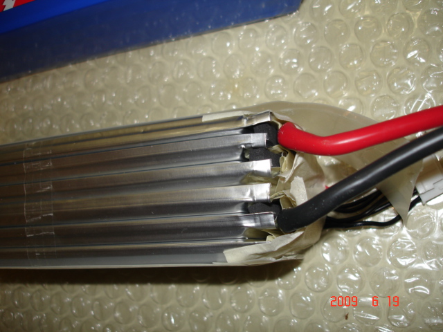

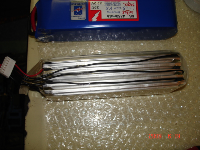

Here are some pics of one of the packs with shrink off.
ID:	7300   Click image for larger version
06.19.2009, 02:05 PM
What is the max mah-capacity a 720i charger can do? 10Ah?
So you are saying you CAN charge the pack with a balance adapter? Couldn't that be dangerous for that little wire? Would you be able to make me an adapter?
But if you say this can't be done easily and fool proof, should I just go A123 pack? I can always keep these packs for my Revo, OR just sell them.
I would charge thru the main leads but make an adapter to link all of the balance taps together so you can balance the packs during the charge via the 720I's internal balancer. The 720I is powerful, on 6s you can charge the full 10amps, as long as your power supply is up to snuff...
