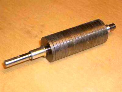

We have 2 guys on our austrian forum running a Lehner 1950 in their truggys. A Lehner 1950 is comparable to a Neu 1515.

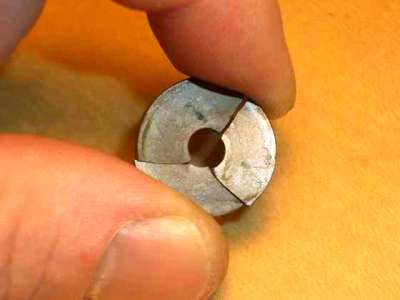

One of them managed to crack the first segment of his rotor while his plastic spur lost 2 tooths. He was running an old design Lehner 1950 without fan.
pictures from our member Josi on www.offroad-cult.org
Lehner changed the rotor design to prevent the first segment to crack (it's always the first segment that will crack when excess stress is applied on the shaft).
There is now an aluminium plate in front of the first segment and the magnet segments are covered.
When choosing the fan version of their motors you should cover the air intakes.
A look inside a Lehner 1950 can. Windings are layed out very properly.
pictures taken from http://sites.google.com/site/planbparts/. Our moderator on http://www.offroad-cult.org
