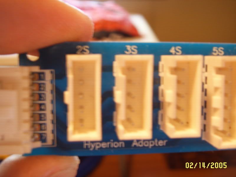

3s lipo balance tabs should have 4 leads right? So why does the adapter that came with my charger have 5? even the 2s adapter plug has 5!
Is there a certain type of adapter that I need for non-hyperion lipos lol because this is ridiculous..

that balancer will only work with Hyperion taps- nothing else, even if the pin spacingnis the same. I think one wire has to be on the fifth plug and the other ones start on the first pin.

could you reccomend a good all around adapter for me? and is there any way aside from "testing" with another battery to see if the balancer is alright?

Hyperion adapters don't work with Zippy batteries. You need the JST XH taps for the Zippy batteries. That's probably the reason why you saw smoke.
Check the black strip on your adapter for any broken wires. I seem to ee something between the 3S and 4S taps (2nd black strip from top).

Zippys use a standard balance tap. The Hyperion tap is pretty much maxamps unique. Jst/xh is standard. That's what fits the blinky and other things.

So what do I need to make the zippy work with the hyperion? What adapter should I buy, does one even exist? I sure hope that my balancer is ok.

Google jst to hyperion adapter or something like that. It sure exists all right...

That converts polyquest to jst/xh. You need to convert jst/xh to hyperion.
