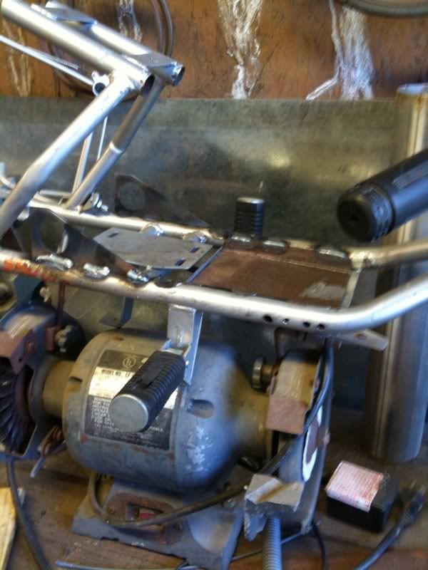

Got a little more done...

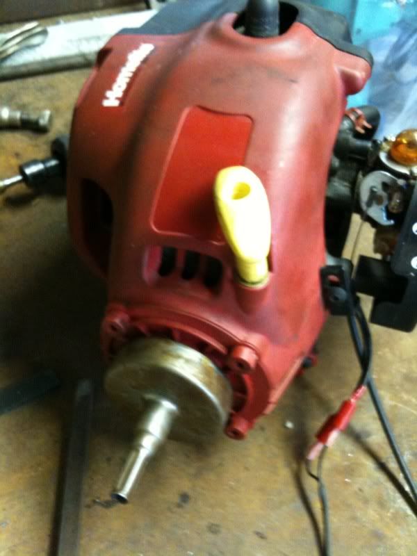

Here's the engine:

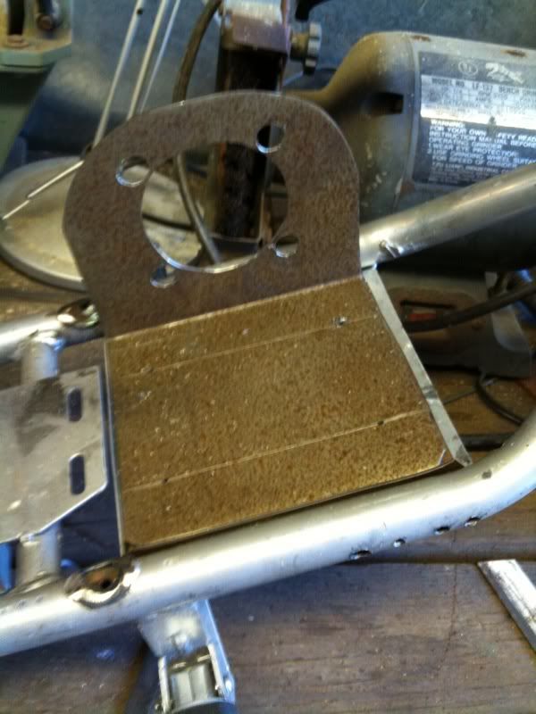

Motor mount almost done- needs to be welded on to the stiffener plate/chassis:

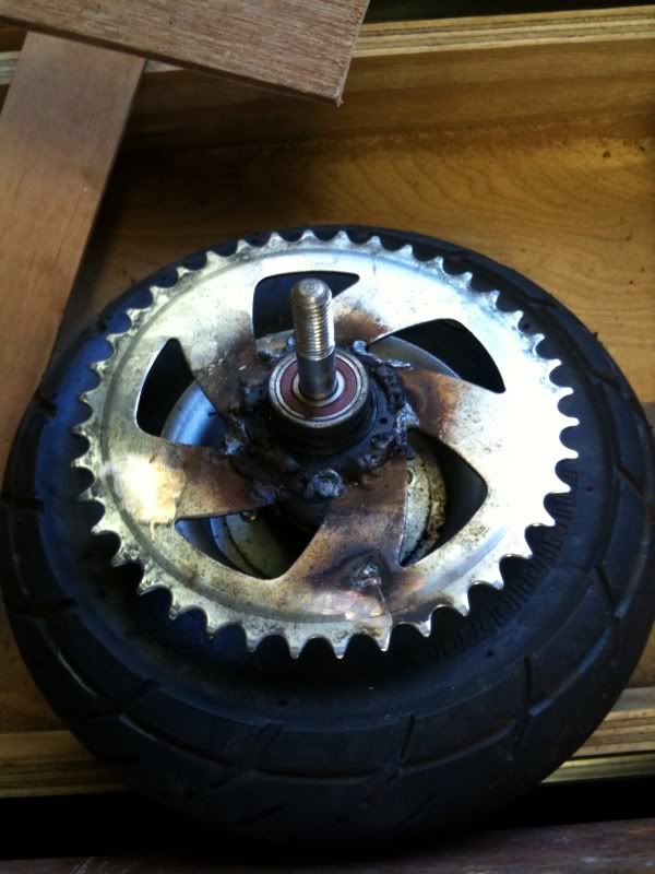

And the rear sprocket mounted to the wheel, this turned out really badly because I had to do this weld quickly as to not warp the sprocket past the point of no return and the fact that the wheel and sprocket are lousy steel, AND I also couldn't remove the freewheel, not press fitted or threaded... so I had to weld it to itself so the motor can help slow the bike down at idol:

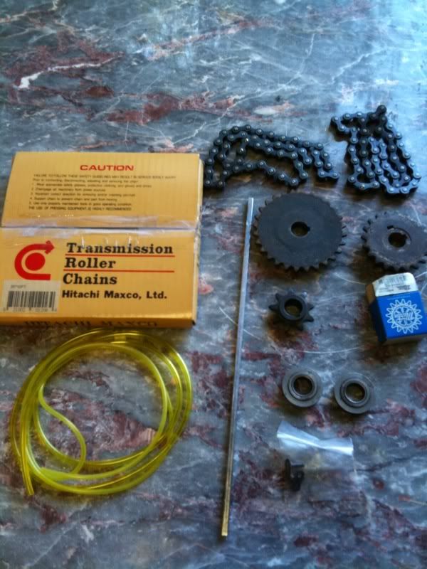

Today, I went to a industrial salvage yard and a lawnmower shop. Picked up a #35 9t 5/8" sprocket for use on the clutch, a #35 28t 5/8" sprocket to use as the primary on the jackshaft, a #35 20t 5/8" sprocket to use as the primary on the jackshaft if the bike isn't quick enough, a #40 9t 5/8" sprocket to use as the secondary on the jackshaft, which will run to a #40 40t sprocket mounted on the rear wheel, pictured above. I also bought some fuel line, #35 and #40 chain of the correct widths, and some 5/8" ID 1 3/8" OD flanged sealed bearings for the jackshaft. I have everything except the twist throttle to get this running now. Hopefully I can get it all together by sunday night, providing I can get a full day's work in on sunday. I will get pics as well.

Sorry, I was too busy looking at that lousy weld job
Get it running. I wanna see some sparks.
07.11.2009, 12:49 AM
The weld is better than the pic looks actually. And i had to weld the freewheel together because I couldn't remove it, and need the engine to help slow the bike down, as the drum brakes aren't worth the $5 I paid for the bike roller...

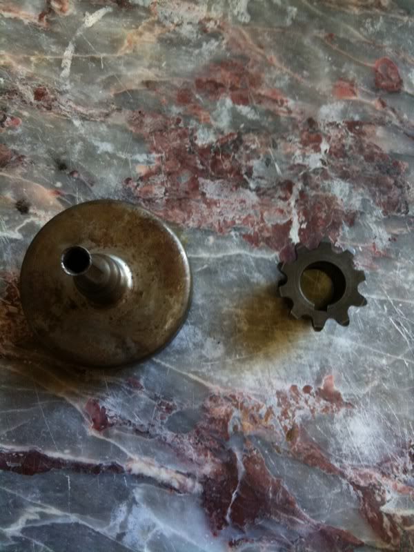

More progress.
Goodies:

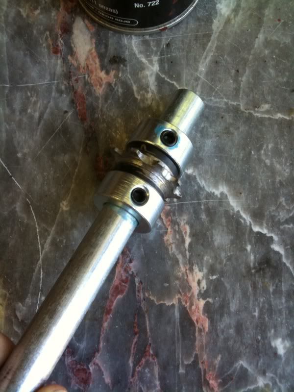

Clutch and its sprocket:

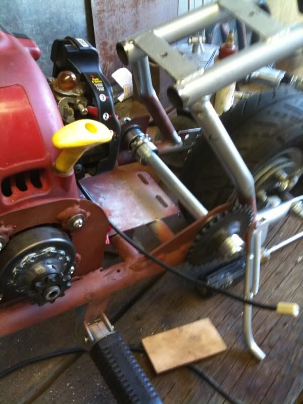

Welded some jackshaft bearing mounts and the stiffener plate:

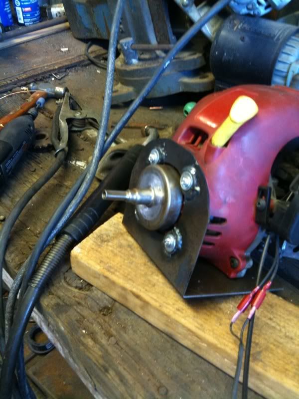

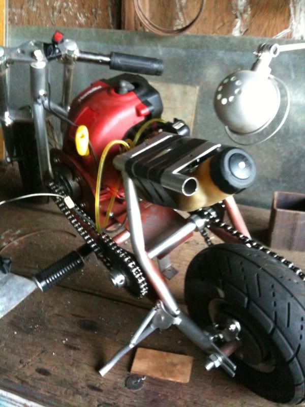

Fitting motor mount with welded on washers:
Motor mount complete:

Seems like it's geared for about 20mph. assumming 9K at the motor and a 10" tire. I came up with a 13.8:1 ratio without your maybe sprockets if I read it right.
Personally I would at least support the rear of the engine or put a gusset ot 2 in the motor mount. And I don't know about the clutch it's probably a little light for the application without a lot more ratio or a varaible trans, looks like a fun project.

I'm geared for about 23mph. Thanks for the suggestions guys, and yes the motor mount is gusseted.

I see now thought that was a shadow.
