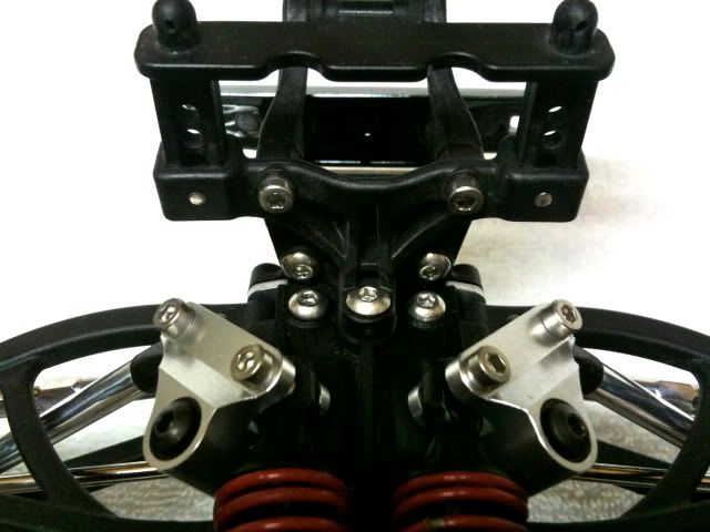

Yes, roughly a 45degree bend and sandwiched it between the bumper and bracket. I used a 4-40 screw that was a tick longer than the stock screw also.

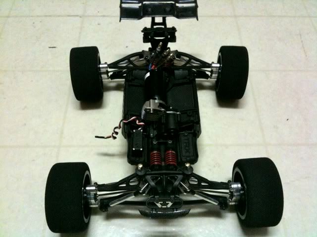

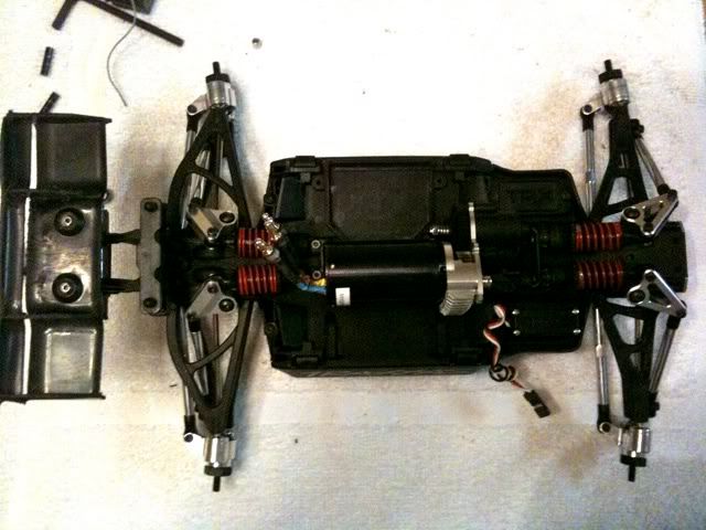

OK guys, well, here's just an update on my Neu MERV:
Project about 1/3 done. Still waiting on a bunch of aluminum parts and the MM PRO. I just ordered a Neu 1115 to replace the Neu 1112 I currently have in there. Overkill, YES, but it's fun and I like speed and I'm addicted to this hobby. I do still have the Tenbol 540 mount and the Castle 5700kv motor. Those have been collecting dust since Castle has had my MM in repairs for over a month. By that time the MM Pro will be out. I'm working on a CF extended chassis but I'm running into some problems as the front has a kickup and the rear has a slight kickdown. BTW yes, I know aluminum bends. I'll deal with it. This one is going to be strictly onroad bashing and speed runs with my next MERV project being a bulletproof all out basher.

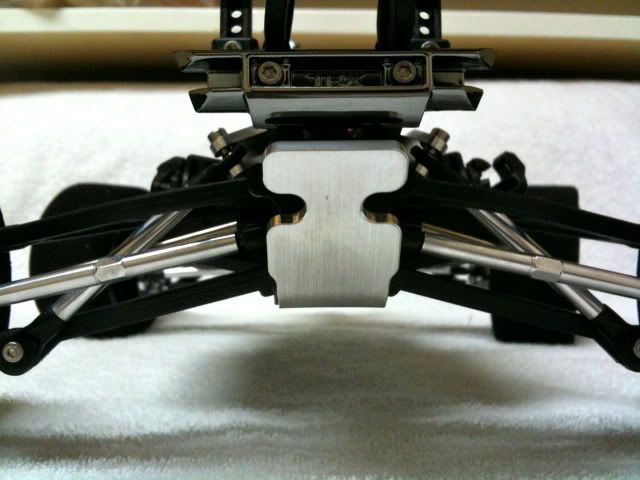

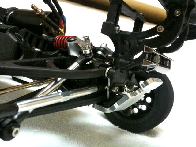

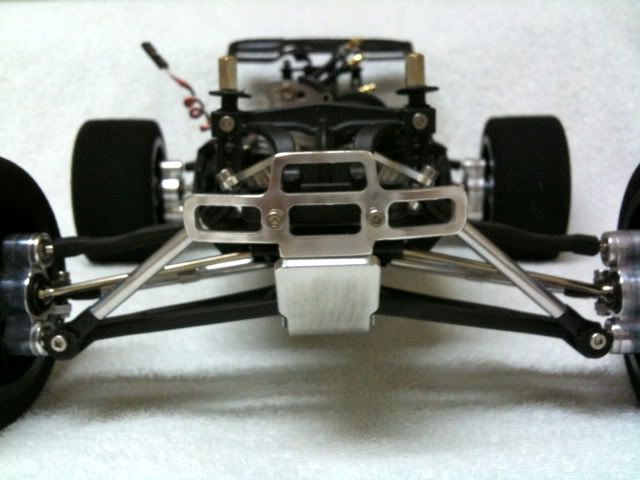

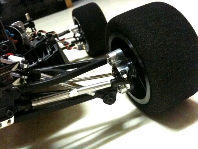

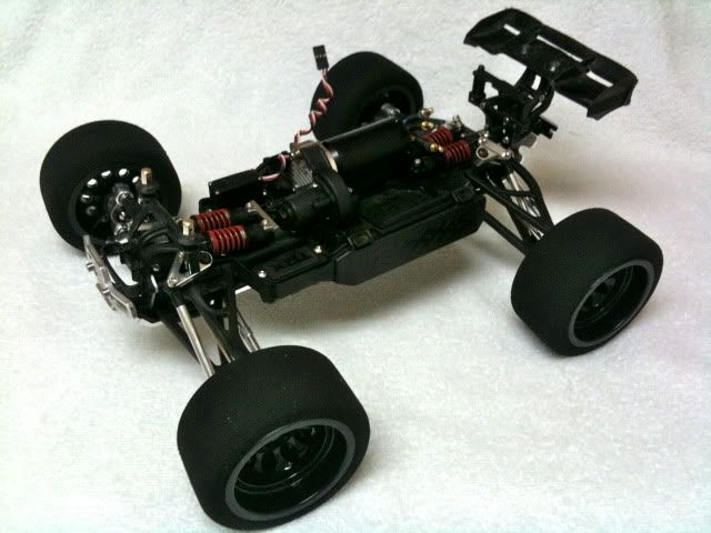

Got just about the rest of the aluminum on:

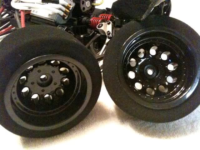

So where can I get some of those wheels/tires for my slash
Wheels are RPM Revolver WIDE crawler wheels. Foams were custom made by Gone_Banana on RCTech. He's a good guy and I'm sure if you contact him he can make you foams for which ever wheel you want.

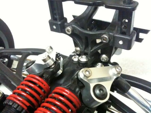

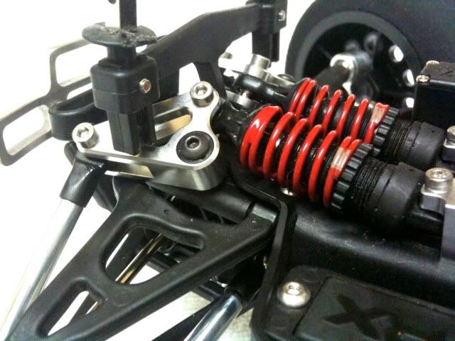

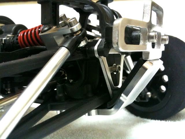

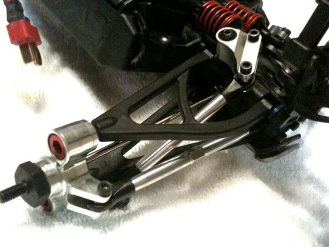

Got the rest of the shiny stuff on:

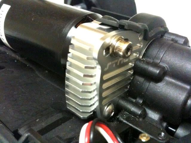

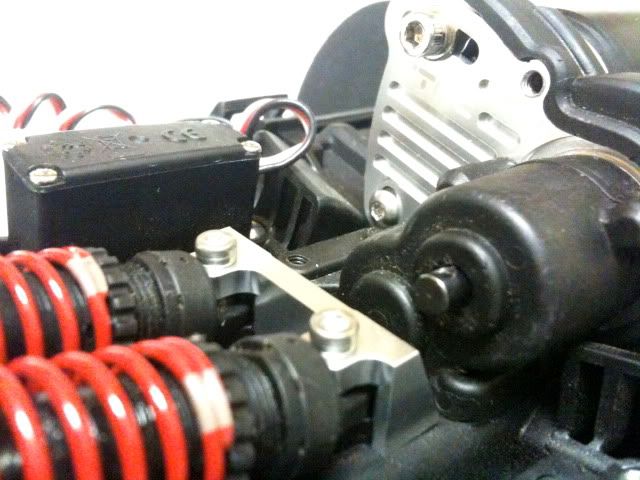

Up in the air with the motor still. That's actually on hold until I figure out how to design this CF chassis so I have some clearance between the shock mount and the motor.

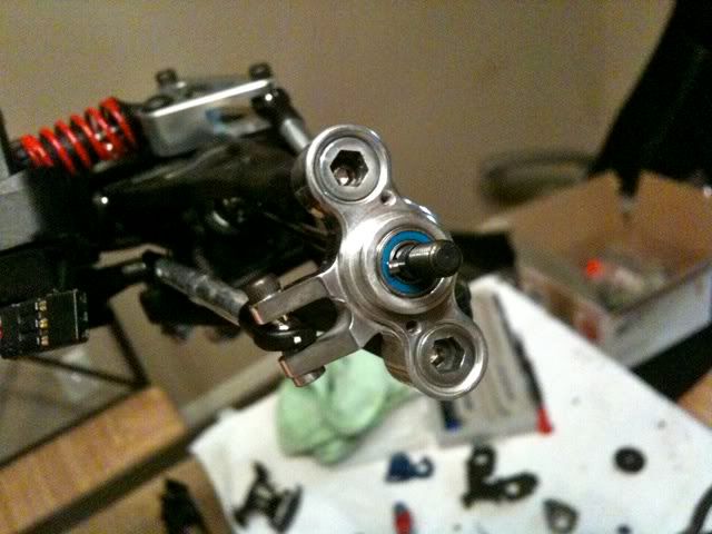

Wow, that looks nice. I like how you swapped out all the bolts too. Is that a kit, or did you raid the local hardware store?

phatmonk
RC carbon junkie
phatmonk's Avatar
Posts: 634
Location: Iowa
10.02.2009, 02:30 PM
Dude thats freakin sweet!!! How much does it weight.Are those foamtires available for a mini Slash

10.02.2009, 05:07 PM
Thanks dude, I'll post the weight tonight when I get home. Foams are custom by Gone_Banana over at RC Tech. Feel free to message him. He makes some quality foams for whatever wheel you want.

Semi Pro
Semi Pro's Avatar
Posts: 1,402
Location: Twin Citys Mn
10.02.2009, 05:20 PM
i like your idea for body mounts LiqrSicc, im going to have to try that out on mine
