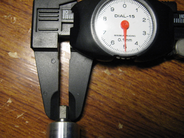

Please see the photo.

Ok, gotcha...I didn't know the pinions were being hexed on the end. Thanks for clearing it up.

They aren't hexed, thats just a flat spot for the set screw.

Gallagher: In the pic I posted above, the left side is what sticks out of the diff, and where the stock sliders mount...is this how you did it? There should not be any dremeling of anything to make any of it fit (except removing the little piece from the E-Revo chassis).

Gallagher
08.12.2009, 08:40 PM
Yes, I did as online manual says.
I discovered the length of left end in the pic between the case is a little bit shorter than the stock and this is how the friction happens. Maybe the case is a little bit thick than the stock or the overall length (in the dimension of output shaft) of the diff inside is shorter the the stock. I also discovered there is gap in the output bearing housing between the bearing and the case. It means I may need put some shims to fill the gap up.
