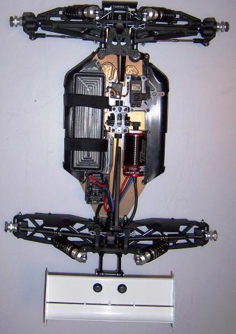

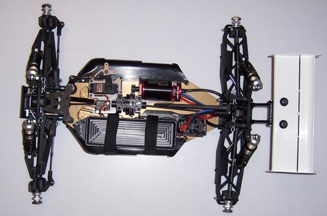

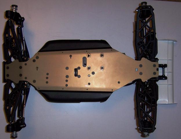

I attached a few pictures of our "stock chassis" mbx6T conversion - will be ready for sale in a few days. Everything bolts onto the stock chassis - no mods required. The battery/esc tray is pocketed on the underside for wire routing, and drilled at the ESC location for the Tekin RX8 as well as the Traxxas MMM hold-down. Built in rx mount with transponder mount is similar to our other offerings. A unique and handy feature of this kit is the fact that removing 12 screws allows the owner to completely remove all the electronics from the chassis without unplugging or unsoldering anything. :)

The ESC bolts onto the back of the battery tray. All one piece. Makes for easy removel for cleaning/maintenance. 4 screws hold the steering/rx/transponder plate(plus 1 screw for the steering linkage). 2 screws to loosen the motor from the motor mount(or 4 screws to remove the whole center diff assembly). 5 screws for the battery tray and all the electronics can be removed without unplugging or unsoldering anything. The entire "power pod" can be removed in about 1 minute(maybe 2 or 3 if you take your time).
The battery tray has quite a bit of machining on the top and bottom, actually - starts out as a 1 pound, 4oz piece of plastic and ends up to be 3oz total weight when complete. :)
