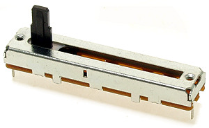

I found a 5k ohm sliding pot that could be hooked up into a throttle pretty easily. Just put a small rubber band on it (gluing the ends) to return the throttle to neutral and I'm set..

Got a link to this sliding pot? I get alot of entertainment out of electrifing/motorizing things, so I'll probably so a lot of these conversions, and that would come in handy. Oh also, nice find on the #25 stuff! The place I went to doesn't have a website, but it is basically a place that buys stuff from industrial companies that are going out of biz usually, with a old guy behind the counter, where you just go, pick out what you need out of piles and shelves of crap, and the guy gives ya a price (usually real cheap) and you walk outta there..

I found the pot at electric scooter parts .com under the throttles section - http://www.electricscooterparts.com/throttles.html
