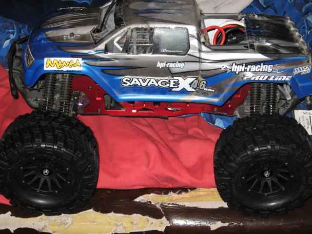

im currently using HPI's Supper Mudder tires on maximizer beadlock wheels. i love them work excellent on pavement or grass dirt seems to be a pretty versitle tire.

Kinda looks like Proline Mashers ... only different

did you happen to weigh them before you mounted them?
lot larger diameter\profile then the mashers. 165mm diameter vs ~147mm

no i didn't i don't have that kind of scale.

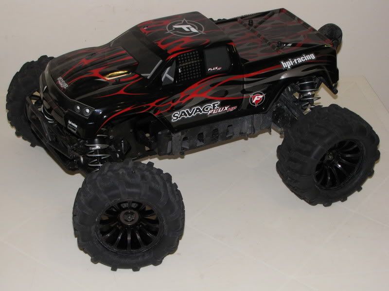

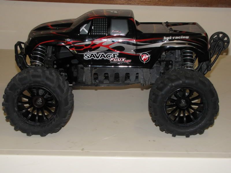

Couple of quick pics. Just finished putting this combo together. HPI GT S tires, HPI firm foam, JConcepts Rulux 1/2 offset half ups (3.7 inch diameter) dyed black. Tires are mounted on the inner bead of the wheel and strapped with tape. I glued both on the inner bead and the outside edge of the wheel. This gives the GT S tyre roughly the same profile as an MT sized Badlands.
Combo weight is ~360gm (wheels are 60gm). Also, i'm not sure how i got the GT S\Maximizer 386gm weight in prev post. When i reweighed it was ~400gm which seems right as the maximizer wheel weighs in ~100gm.

Looks good! Are those LST shocks you have on there? How are they holding up with bashing?
_dV
Posts: 233
Join Date: Sep 2009
01.08.2010, 09:46 AM
They are the all plastic Aftershock LST type shock with Hot Racing shock cartridges\boots and Raven dual rate springs. Haven't had them for long but they are standing up ok so far. I popped a cap and bent a shaft on one after a rather high nose dive off a bmx jump with 40 centistoke oil but apart from that all good.

How's the air control with that taped GT S'? I taped my 3.7 road rages and air control was terrible so I sold them. (on the erevo) Don't want to screw up again, but I don't think there would be so much ballooning on 4S.
  (#30)
_dV
Posts: 233
Join Date: Sep 2009
01.08.2010, 05:51 PM
V0RT3X: Took the new wheel\tyre out for the first time yesterday for a short run. It was only on flat ground though, no jumps.
I have run with these tires taped briefly on smaller diameter wheels and air control was fine. A little more sensitive than other wheels i have run which was probably due to the higher relative mass of the tires to the truck. I've also run taped badlands and air control was great.
What happened when you taped your road rages that made air control terrible?
There is a lot of ballooning on 4S with the Flux.
