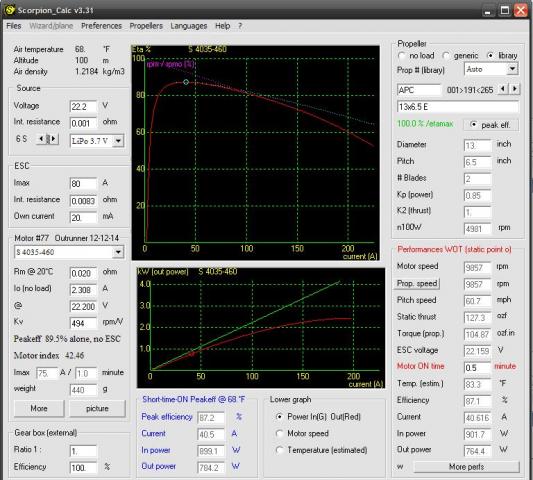

You can get the Scorpion Calc here:
http://www.scorpionsystem.com/downloads/
(2nd item on the list)
So it will use truggy diffs. Will the outrunner's output shaft be a part of the diff input shaft?

Thanks for the link Metalman, I DL'ed it, but it doesn't really do us surface guys any good as it is based on max rpm loads, and not full rpm range. It states a peak 90% efficiency which is nice.
