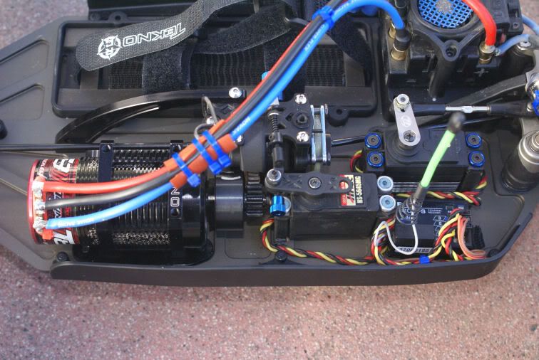

Hi, I came from a nitro background so I was looking for a mech brake setup. When I started there were no kits that allowed mech brakes so I converted a Kyosho ST-RR myself and retained the mech brakes. The truggy was great and for me the mech brakes is what I felt comfortable with. This year I decided to try a Losi 8igth-T 2.0 and at first I went with the Losi kit and motor brake. The motor brakes worked great and it felt comparable to my Kyosho, lap times were almost identical. After a few months with the motor brake setup I decided I wanted to go back to mech brakes to reduce the load on my electronics and to allow brake bias. So I picked up an Tekno kit, which I have been using for about a month. The Tekno kit is great, the bias control is a plus and hopefully my electronics will hold up better when summer comes around and I see 100+ temps here in SoCal. So I have used motor and mech brakes and they both work fine, both setups have pros and cons, it's all about preference and what works for you.
Tekno kit with mech brakes
Losi kit with motor brakes
Kyosho ST-RR with mech brakes

Hi, I am running the setup in the first picture, Tekno kit using the clutch. You will get some strong opinions regarding the clutch and I was originally not to thrilled about it because on a Revo conversion the two shoe clutch didn't work all that great (it got really hot). But the new three shoe design is much better and runs cool. Yes you can easily use the long shank pinion for a direct drive with the Tekno kit, and I do have a couple of long shank pinions I was going to try out but I like the clutch system so the long shanks are just in the tool box as a back-up. Yes you can dial in brake power via the ESC, but as you stated you can not adjust brake bias, and I prefer more rear bias to help the truggy rotate better in certain situations. I feel the mech brakes are more important to a racer as a tuning option.
