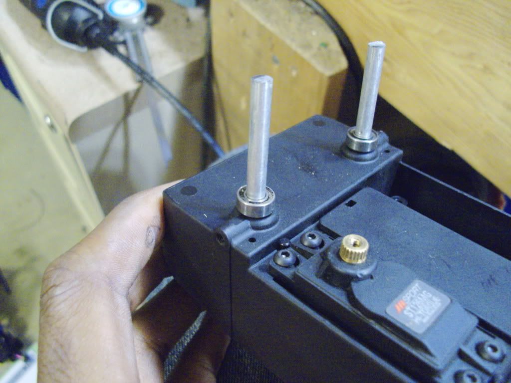

Agreed, Looks beastly next to the buggy. Clever thinking w/the pins.
Keep us posted.
12.06.2009, 10:37 PM
Keep us posted.
Thanks, they are hardened steel so ill be surprized if they ever break(knock on wood)
Will do,

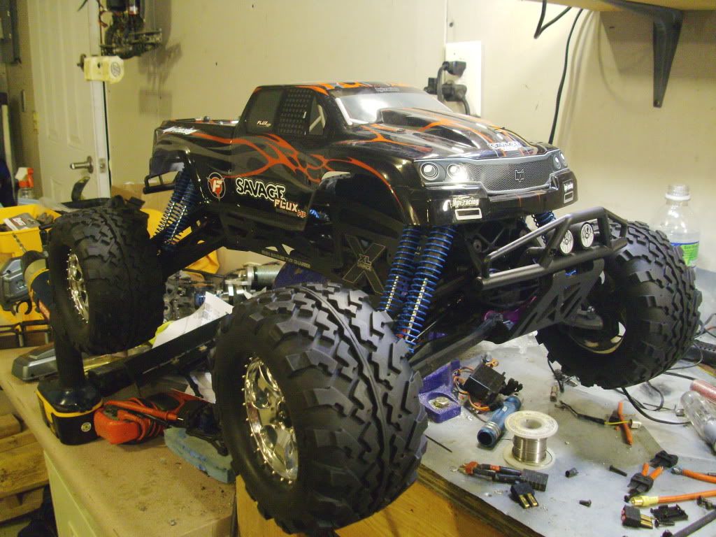

Love the xl chassis. Going to be a sick build.

hah, funny to find all my old parts wondering their ways on your build. that means i get to run it first!

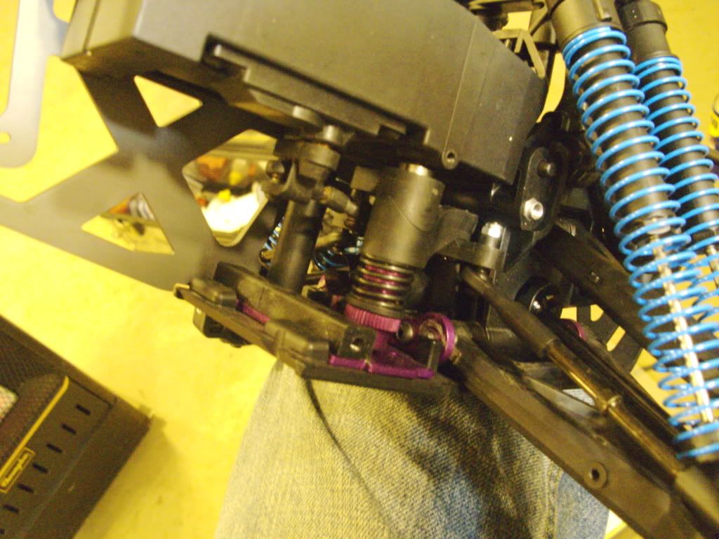

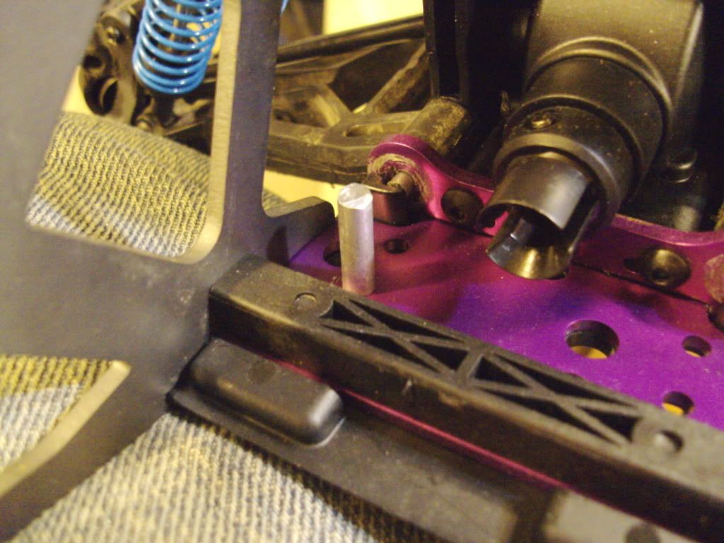

Im Basically remaking the large motor plate and braces as one peice, from 1/4in aluminum...

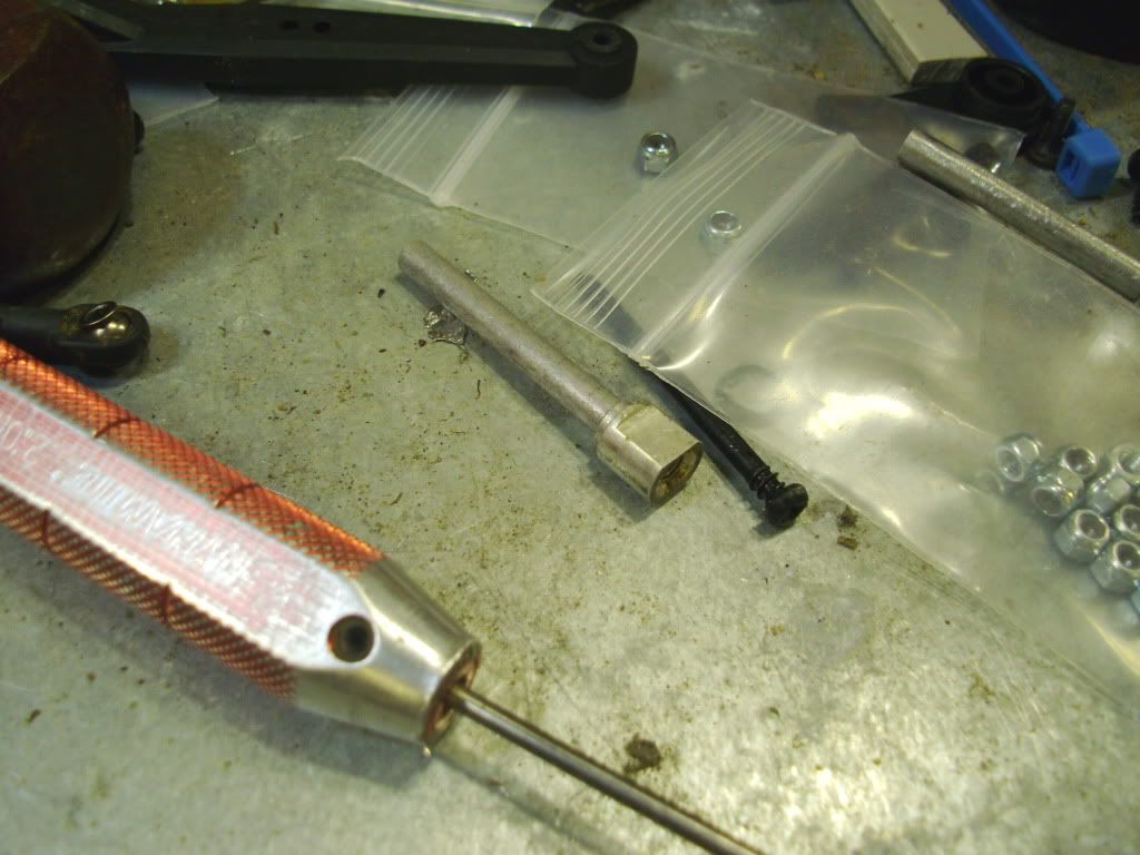

Winter sucks.. snapped a drill bit, Got that out, tried to thread a screw in, snapped the head off, drilled it out, then broke my m3 tap in the hole... cant get it out, so i ground it flush..
But. I mounted the transmission. roll bar, center driveshafts, rear toe links.
Had to improvise as I had no transmission output cups. Used 1mmthick aluminum sheet metal. Made a sleve for the transmission output shaft to fit the differential pinion drive cups..
It can sit on its 4 wheels by itself now!
