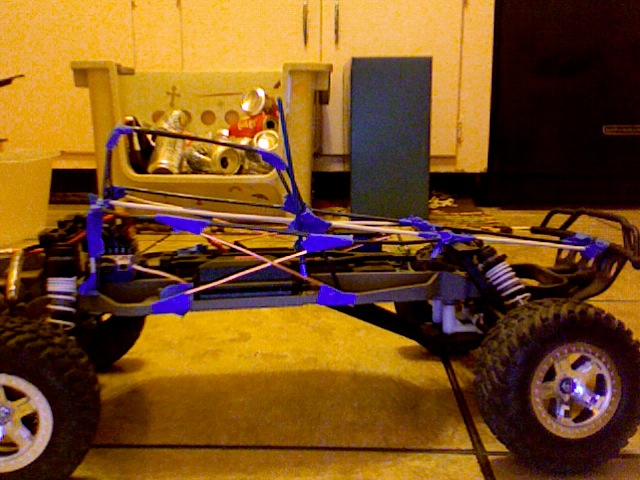

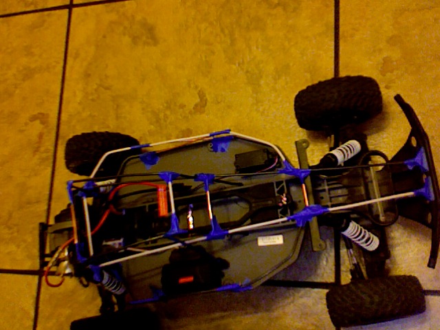

Here's the first mock-up (using electrical wire and painter's tape).

I think the cage could be at least the diameter of the front bumper, and still look scale.
Also if you get thicker material, you can heat it up and flatten it, then drill it. Would simplify end mounts and intersections for the cage...
Edit: I see you got 1/4".. that or 5/16" would be fine

Yeah, I'm going to start experimenting with the abs next - the above photos are just a first run mock-up. Got a long way to go! I may need to order some more abs, too.
The big questions I'm hitting are where to put the joints/welds as I build in order to get the toughest structure for rollovers. Though I think the body panels will add a lot of stability to it as well. The plan is to attach them with zip ties.
