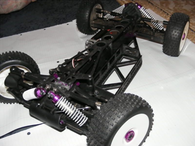

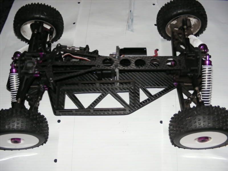

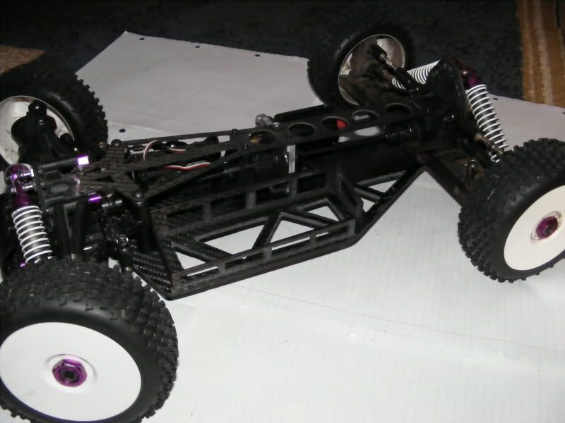

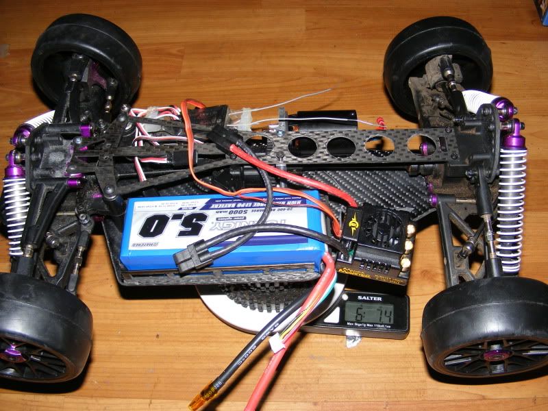

I then decided the chassis wasn't light enough, took everything off the chassis and cut out areas under the motor, servo, ESC and battery leaving just a solid strip down the middle between the 3 diffs and I made a rear shock tower while I was at it.
Xray XT8, 1518, MMM, 4s5Ah.

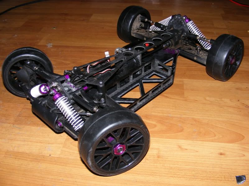

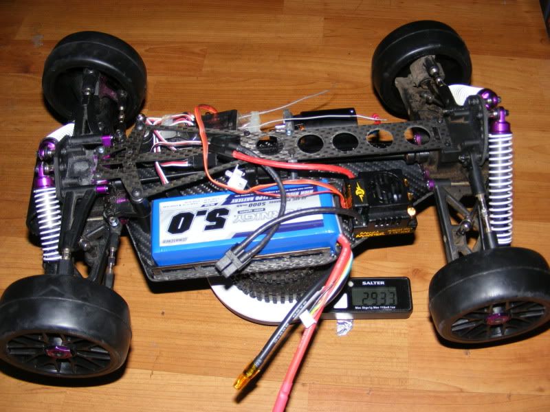

Almost ready to run now, just a bit of soldering and a new hinge pin needed, I did forget the body mounts though so I may have to make new front and rear shock towers but I may have room on the rears as I left a fair few unused holes for ride hight adjustment, and just make a bumper with front body mounts attached like proper rallygame cars do.
Here's the ARTR photos
and on the scales
For you yanks that's

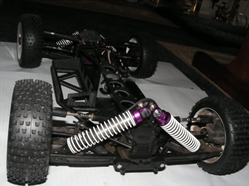

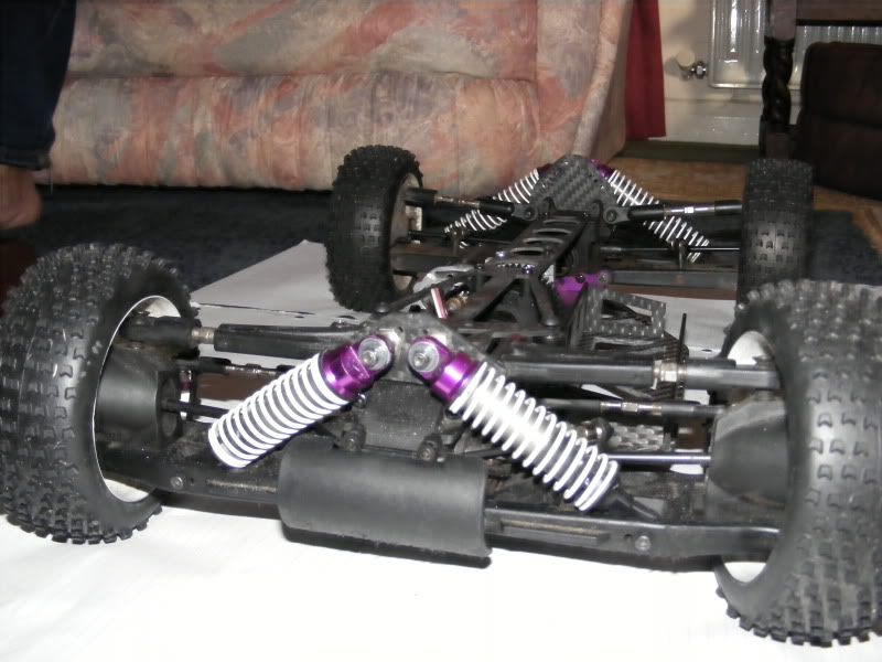

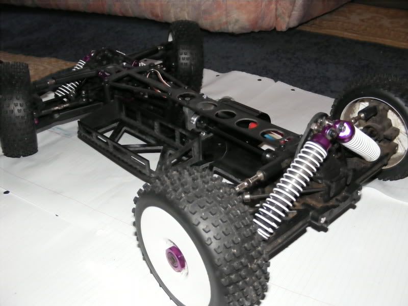

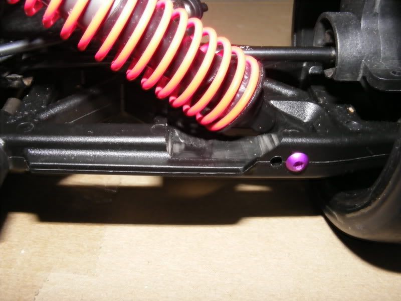

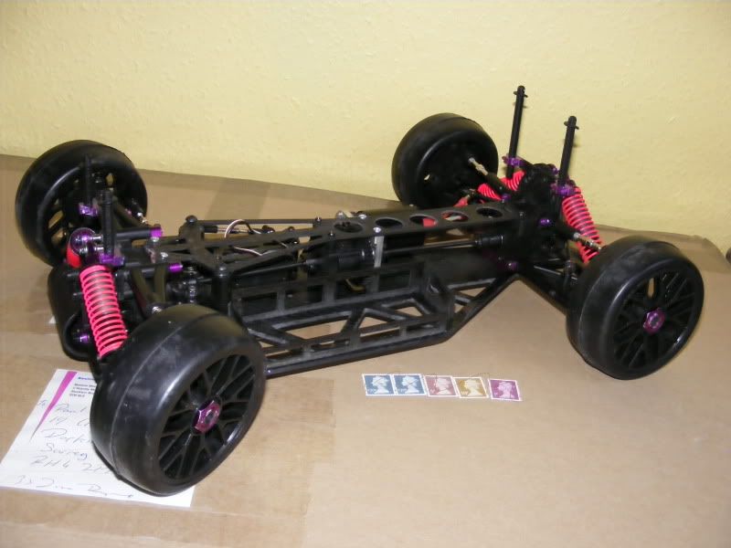

I got some more done over the weekend, I was having some trouble with the shocks, with the angle I am laying them down at the lower spring seats were hitting the bottom wishbones and limiting suspension droop, so I bought a new set of wishbones and carved away the areas that they were hitting, I also took the opportunity to stiffen up the suspensionlaying the shocks down had softened up the initial movement and put more progression in it, so I rebuilt the shocks wit 70weight in the front, 80 weigh in the rear and stiff springs all round.
Fronts
Rears

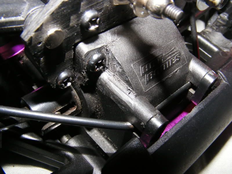

However now the spring seats aren't limiting droop, the springs hit the front diff housing and that limits droop although to a lesser extent, so I will have to take it apart again and modify the front diff housing.
I made up some body mounts, the front ones aren't perfect though i should have made them taller, so I may well remake them.
I also replaced most of the M3 screws under 20mm long with some alloy ones I had laying around from another project, here's how it is looking now.

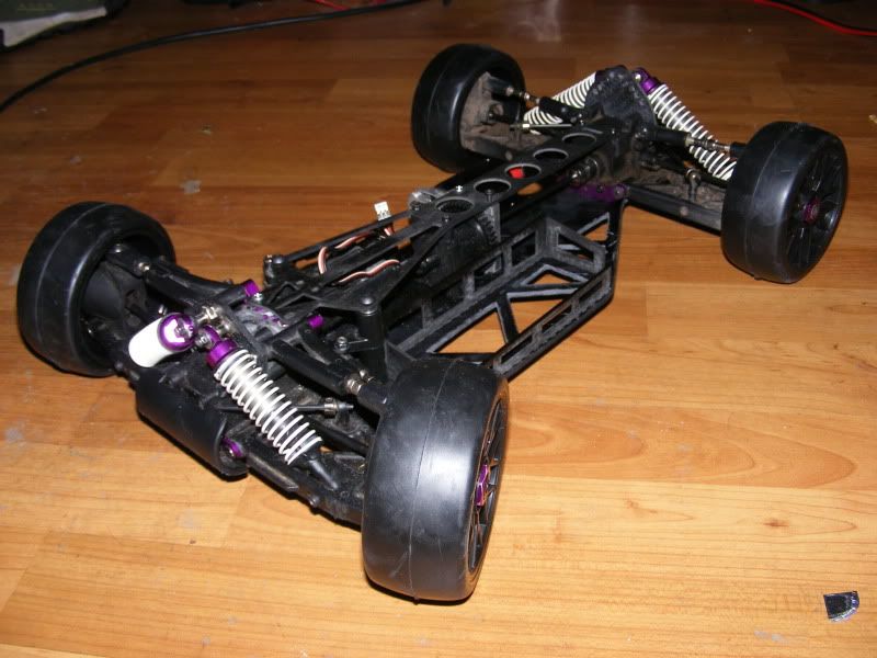

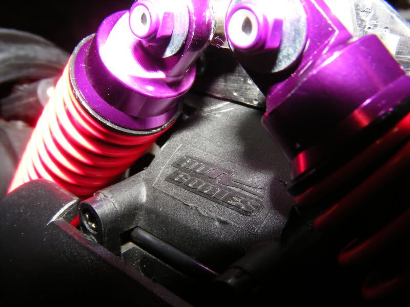

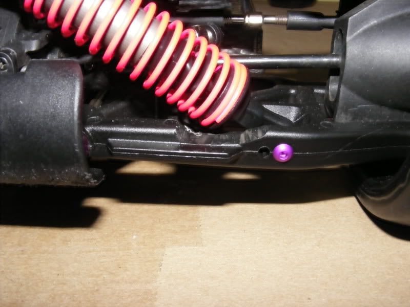

I finally got round to modifiying the front diff housing, the screw faces for the top clamping screws needed moving back 3.5mm, and there was just enough meat in the plastic to get that far back, another .2mm and I would have perforated the housing. I also had to shave off a strengthening rib, but with its placement in an allready high strength area I am not worried about having weakened it too much.
Now the springs just have a microscopic amount of clearance at full droop increasing as the wheels rise.

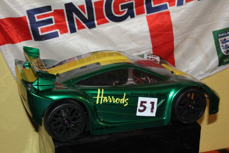

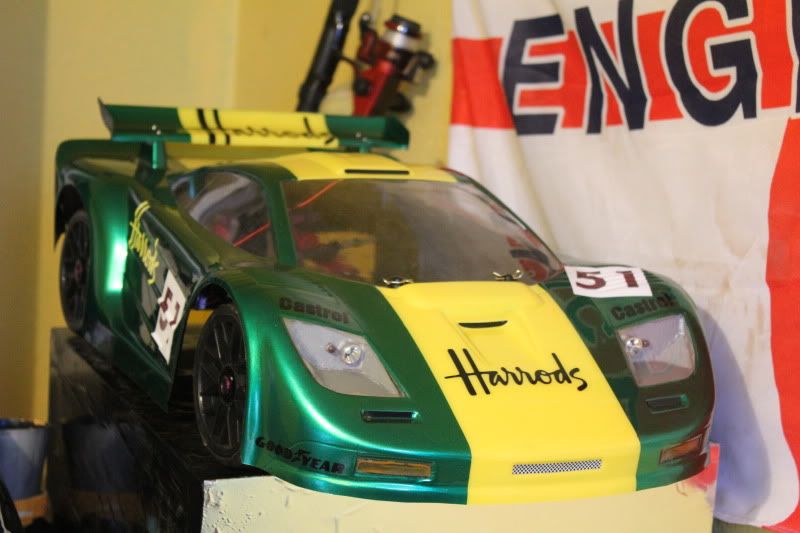

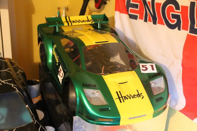

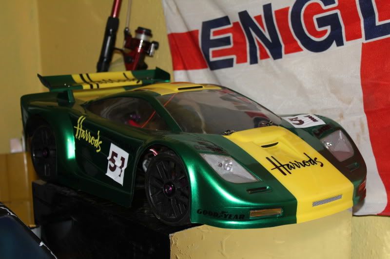

With the full Asphalt conversion the Ford Focus WRC body was a little out of place, I wanted something lower, racier and with more downforce, so I asked around before Xmas, and come Xmas day there was a ghostly transparent Mclaren under the tree, I had to wait for decent weather to paint it so that was only about a month ago, then it took me a couple of weeks of making and remaking templates but the week before last I finished my light buckets, installed them and fitted a lighting unit to the body.
Last week my Vinyl decals arrived and I installed them all (except the BMW roundels which got the sizes mixed up, but replacements are being made this week)
