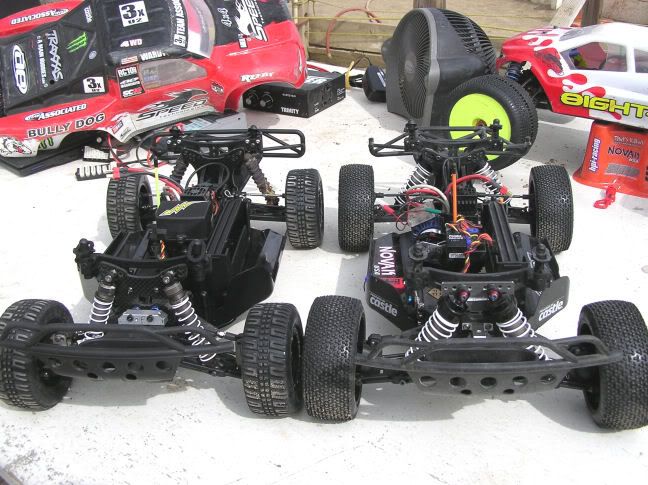

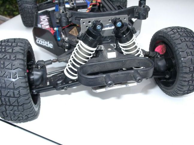

Shark413
Shark413's Avatar
Posts: 468
Location: Los Angeles, CA
03.10.2010, 09:38 PM
Originally Posted by superek4 View Post
No just wonder what's the benefit as I am going to use 14mm shocks from x1 jammin cars.
The benefit is more travel. You want to increase the travel (in front) but you don't want to raise the ride height, so you need to increase the up-travel. The stock Jammin SCRT10 front shocks are really short and don't have enough travel. If you use the rear shocks in front (or any longer shock) you can gain some up travel. To use longer shocks you need the extended shock tower. Just don't get carried away with the front up travel as too much and your CVD's will bind under full compression. Use the SNR tower and stock Jammin rear shocks and you won't have any issues.

Shark413
Shark413's Avatar
Posts: 468
04.26.2010, 09:02 PM
Originally Posted by JoFreak View Post
Nice SCRT10, I think I read your thread in the RSC forums half a dozen times.
I definately will use that idea with the skateboard glide tape for my truck.
Reminds me that I still have to order it...
JoFreak, thanks for the kind words. It's a little extra effort to take pictures and post up the info, but I learned a lot on these threads so I want to return the favor. How's your SCRT10 running?

Shark413
Shark413's Avatar
Posts: 468
04.27.2010, 01:28 PM
Shark,
How does the one with the 1/8 shocks handle next to the one with the stock shocks? I was thinking about going with the 1/8 shocks on mine so Id really like tou hear what you think.
Jhautz, the 1/8 shocks feel great. It's an incremental thing, the stock Jammin shocks work fine, going to the Jammin rears all the way around was a little better and going 1/8 was better yet. Not a huge difference, but to me it's worth it. I am not an elite driver and make mistakes so I need all the help I can get. The point of going biggger is that you can lower the ride height (especially critical if you go with bigger Slash size wheels) and gain back the suspension travel by increasing the up travel slightly. Going to the 1/8's adds the following, more oil volume for consistancy and stronger (shafts).
