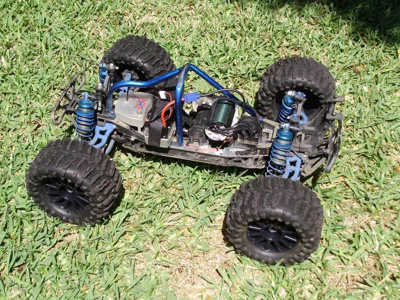

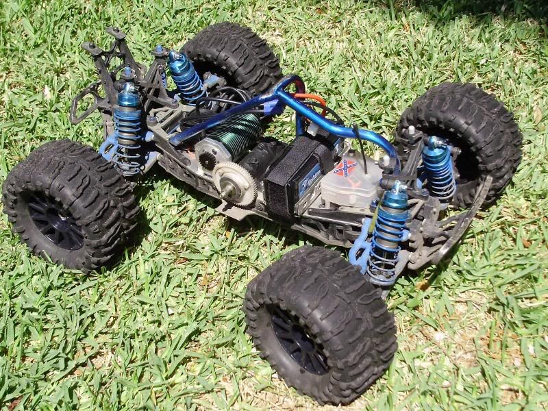

Those look great! Thats such a great off road tire as well! TONS of grip!
I think 6s will really be the sweet spot on this motor. Just a little low on the RPMs on 5s for my liking. I know you have plenty of 5s packs tho...
Cool,Thanks. You like them cause they were yours JK
I cut the bead off and pulled them over some trimmed down 1st generation 420 Wabash's. When PL first released the Wabash they also had black rims, I ben hangin' on to these a loooong time waiting for the perfect tire to complete the "look" I was after.
I'm hearing you on the 6s packs being the honey spot for this motor, I'm axious enough without you keep reminding me ! I should have the new ones I ordered by Fri, fat fingers crossed.

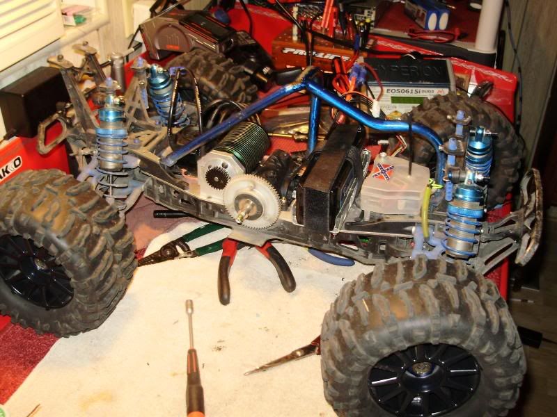

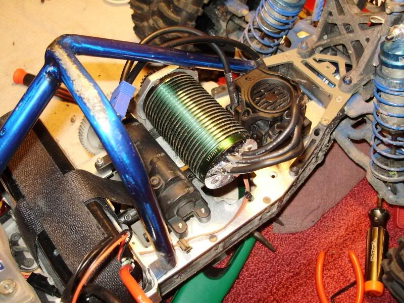

Finished up all the loose ends and fine details and threw in a 5s 5K pack, did a systems check and applied throttle and next to nothing ? I was like WTF ?
After a quick check w/a volt meter I discovered a discharged pack, I have no other 5s lipos to fit this bat tray without adding a bunch of padding and by the time it finishes charging it'll be dark. So to hell w/it.
So I will test Thursday and capture some video if someone is around to hold a camera.

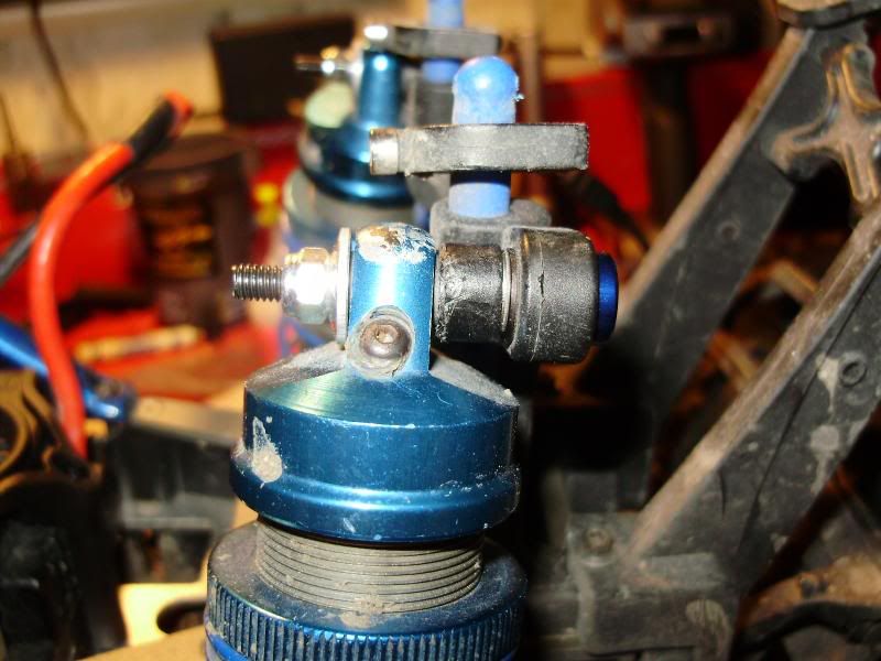

4mm shock bolts
Motors sealed via ShoeGoo and aluminum tape
Trusty Hyperion Duo getting R done (What a PITA to learn to use this charger, but wow what a kick ass charger !)

Nothing to special, just test running in front of the house. Couldn't really open it up due to the way the street is designed with a large median but the low grunt of this motor is very apeasing to say the least ! I ran it with a Zippy 5s 30C pack and even though the pack wasn't even 90 degrees it was slightly puffy after 15 minutes, so I think 30C isn't enough for the demands of this motor. The pack is great Lipo, I ran it with the 1518 for a couple months with no problems, so it has to be the 1717 pushing the pack. I hope the 6s 30C packs I have coming will be enough ?
I may try my luck w/HC 40C 4000's, but If I have to buy some Polyquests or Hyperions I guess thats what I'll do ?

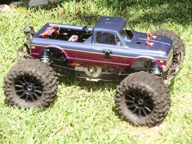

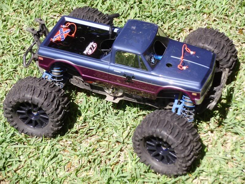

Knocked some XXL post holes into a body I've had for a couple years but didn't want to ruin, seemed fitting to have a nice body over this new motor ?

great looking truck,but whats with the pullstart? a little joke of yours on the nitro guys? lol--josh
  (#30)
Bondonutz
Fat Kid Engineering
Bondonutz's Avatar
Posts: 3,634
Join Date: Jun 2009
04.29.2010, 12:30 PM
Thank You.
Yeah, It's a Rib (joke)
Ever have some moron ask you if your truck was gas powered ? I have,frequently.
I can just say yes now. It has a really good muffler
