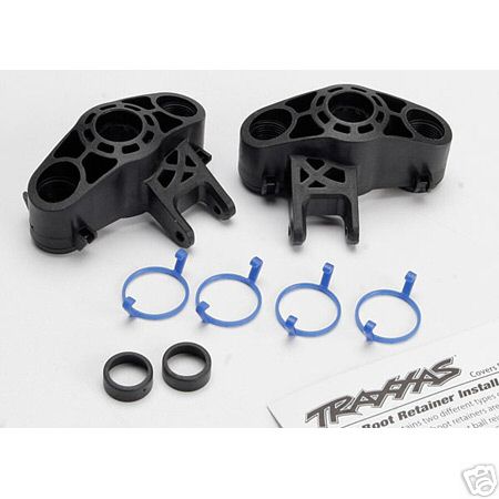

When switching over from TRX carriers to RPM carriers there is a metal ring on the back of the TRX ones that gets often over looked. It must be removed and installed on the RPM carriers or the balls will pop out constantly (sounds bad?)
You still should check to see if your stockers have that ring, the balls do not pop out and back in again with the ring. If they pop out once they'll surely do it again because the plastic has ben stretched now.

Ring, can u post a pic of the ring?

Here

What, the black rings?

Yes the Rings ?
They are steel and slip over the backside where the threaded part of the pillow balls comes through the carrier. They keep the integrety of the plastic to prevent the balls from slipping through.
