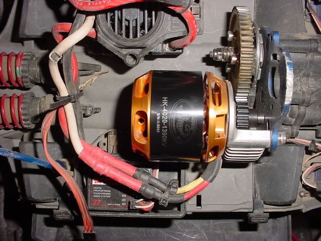

I had an Axi 2826 in my E-Revo until it got slightly damp in the snow and shorted a winding. It was geared 20/40 with mod 1 gears and 5s2p a123. When I first installed it, I hadn't adjusted the slipper clutch from when it was brushed and I twisted the driveshaft into a pretzel.

Depending on where it's run, it won't be a problem with anything getting into it. I had no problems when running on the street or on dirt, rocks, etc. Only when I ran in sand did the outrunner begin to get dirty. It would get dusty, but not get sand in it unless you really crashed it badly, then sometimes some sand would fall out when I shook it after righting it.
The thing I found that was the problem is ferrous dust. Small particles of iron attracted to the magnets. I would take my motor apart every so often and clean this out before it became a problem.
The amazing torque and smooth operation made this worthwhile.

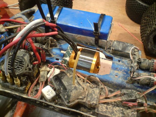

kinda bringing this topic back from the dead but I recently stuck a very cheap 1600Kv 6-pole outrunner in my Revo 3.3 conversion.
geared 15/36 with Elektri-Clutch. it pulls about 70A from a full-throttle start on 6s. Tops out at almost 40mph, but handles extremely well because it's lightweight (9lbs).
I used that motor cause it's roughly the same size as a standard 540, and will fit in the 36mm Tekno mount I had laying around. For larger outrunner experiments (or if I had the 42mm mount) I was looking at the Castle Vertigo motors that were $40, but the only ones left now are really low 220Kv. Kind of hard to gear those properly as you'd only get 30mph geared 30/36 (RCM sells a 30t 1.0M pinion!) on 12s lipo lol.

I use this one. It's almost exactly the same size as a 540 size motor, and works perfectly with the Tekno 36mm motor mount. I just had to drill a hole near the front for the wires to exit...if I need to take it out of the mount again, I will drill more holes for ventilation. It's not a very powerful or extreme setup (running on a 6s 2650mah 20C lipo just fine) but it works well, and makes the 30krpm recommended lower limit.
What timing were you using? I heard outrunners like high timing regardless of what they're in, didn't know they reacted so poorly to bad settings.
