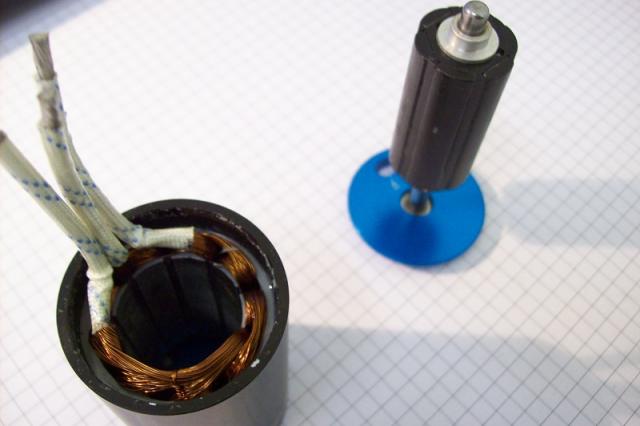

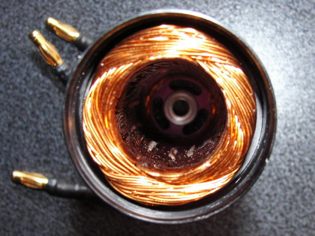

How can I tell if the motor is slotted or slotless? (excuse my noobiness)
outlaw
Castle addicted
outlaw's Avatar
Posts: 146
Join Date: Dec 2010
Location: Hamburg, Germany
01.04.2011, 03:40 PM
First one
Slotless Lehner 1950/8
Second one
Slotted TS 2240/6
ID:	9593   Click image for larger version
kind regards
Mirko
Brushless motors have to be green ....
Pdelcast
Pdelcast's Avatar
Posts: 1,697
Join Date: Mar 2008
01.04.2011, 04:41 PM
Originally Posted by outlaw View Post
First one
Second one
Slotted TS 2240/6
The plot thickens... That TS 2240/6 is a really odd motor. 9 slots, 6 poles?
bizzaro -- I'm gonna have to do some simulations.
By comparison, a Neu/Castle is 12 slots, 4 poles.
