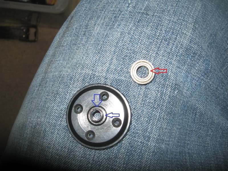

The inner bearing race (red arrow) will be in direct contact with the raised area pointed to on the ring gear w/ blue arrows.
Thanks
02.15.2011, 12:54 AM
That is fine, just as long as the outer race is not in contact with the ring gear.

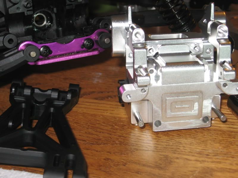

Check out a little custom work i just did.. I am a beast with a file No more nubs.. Needed to get rid of them to fit my bashcat braces.
Now i need to order some M4x40mm caphead screws. The ones provided in the Bashcat brace kit are the right size if you're using stock bulks.. But the outer bulkhead half of the GH set is not even threaded! So i've got to reach a bit deeper with my screws. Im also going to have to open up those un-threaded holes on the GH bulk half as im getting some binding/rubbing there with my screws and its rounding the crest of the threads all to hell.

Only the rear bulk is aluminum. Im trusting your braces to keep the front plastic one together
Very impressed with the Bashcat braces! There is literally no way in hell I'll be able to break or bend these. Fitment is dead-on as well. Thanks again Mr Snuggles!
