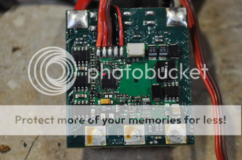

the other bad news is that the mmm still doesnt work, i opened it up to see if the motor bullets on the board had come apart and this is what i saw
is the yellow and lack of solder normal?
thanks
04.26.2011, 03:27 PM
The yellow is most likely just flux and yes, both that and the amount of solder is normal. Really, there is no need to have more solder than that; there are no gaps and the bullets look like they are firmly in place.

Probably a chip on your board is bad.
Pay the 70 to send it back.
