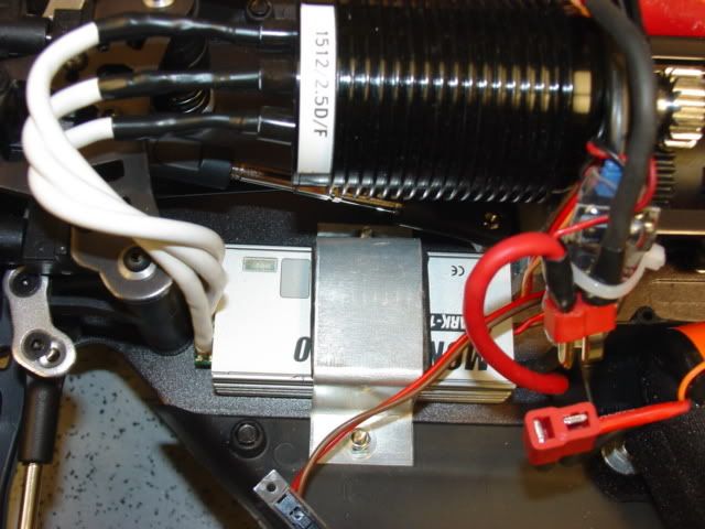

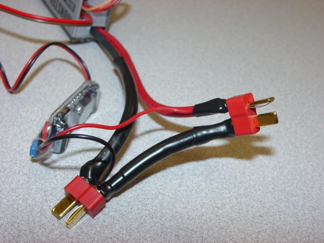

Anyway, I just wired up my speed controller, and I want to make sure that it is ok. Since it will always be used with two packs, I wired up two dean's connectors to it. This will work, right?

That connector arrangment should work just be careful after you connect one pack your other male plug can arc on the chassis, not really a big deal in that brief moment until you connect the other pack.

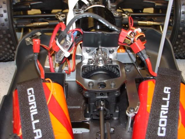

You have it wired good, butthe series lead seems short. i like to have mine a tad longer to leave room to spread apart a tad to get to the batts. But that's in a maxx.

It's just barely long enough. I didn't want it to have any slack, since it passes directly over the driveshaft.

Then you'll be fine! You may want to protect it in case the shaft breaks. i had a shaft break once and flapped around and wrecked my upper plate before....not good! don't even want to know what would happen if it cuts a wire!!!!!!!

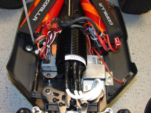

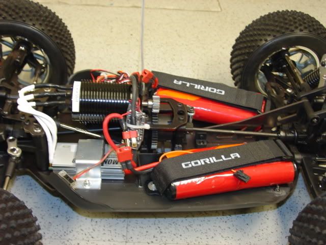

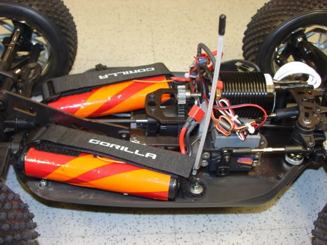

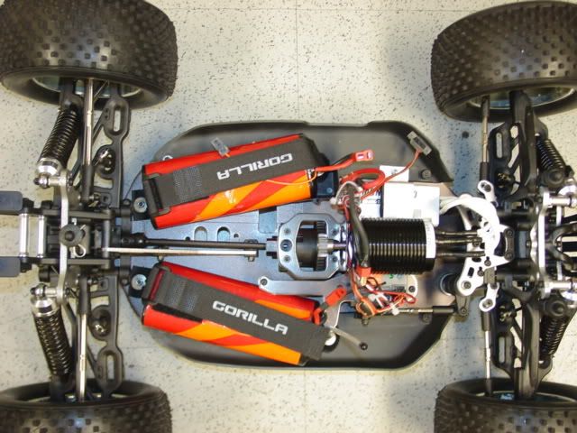

I did my first test run today. I used the A123 packs without the turbos to get a baseline speed. Geared 46/16, the truck got up to 38 mph by my gps. That's almost exactly the 40 mph predicted by Brian's speed calculator, assuming 0.5 in. radius of tire ballooning. With the turbos on full boost, I should be around 60 mph. It looks like I'll have enough speed without the turbos for racing, though. I'll just use the turbos for bashing.
The truck is a mess of wires right now, but I'll post pictures when I get it cleaned up some.

I weighed the truggy and got some pictures of it. I weighs 9.6 lb fully loaded. That's about 0.5 lb heavier than the nitro version. I'll try out the turbos this weekend to see how they do.
  (#29)
