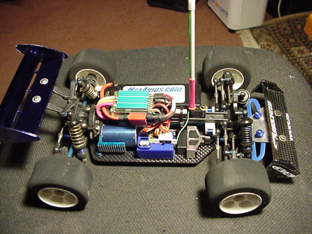

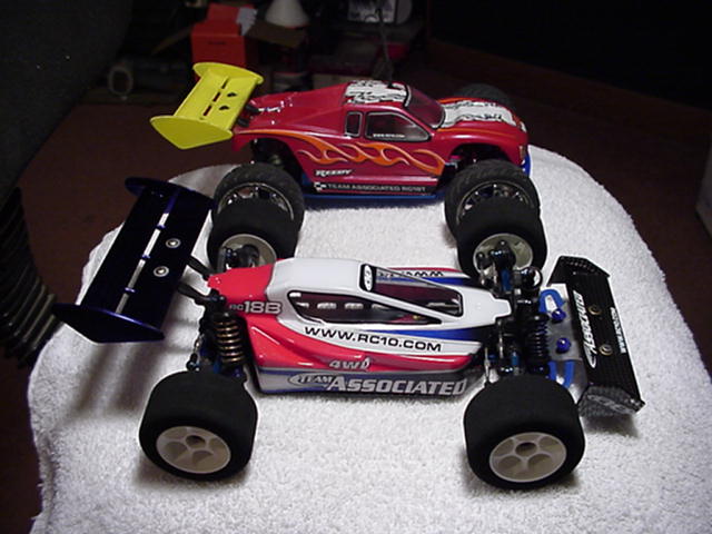

How far can you go with a RC18? this is my 18B that has been over 80mph.:D

Very nice RC18! Too bad you didn't participate in the "Worlds fastest" shootout in California a couple of months ago (or did you) because it sounds like YOU would be holding the title for "worlds fastest mini" instead of Tony Phalen as featured in the December 2006 issue of RC Car Action. He "only" went 76.9mph with his RC18.
What setup are you using in that beast?
Thanks.

Very nice toys! Where did you get the chassis and fins? Also, are you running your shocks upside down?

I built this car after the WFRCC contest but I will be there next year.:D
right now I have a Quark ESC with a Wraith 7000kv motor with a 4s 2100mah pack the front wing really helps keep it on the ground at high speed a problem Tony Phalen was having is the car going airborn above 70mph.
Yes I run the shocks upside down it helps keep the piston suspended in the fluid on bottom out and no leaks I also flipped the rear arms for 3/8" longer wheelbase and mounted the shocks in front of the axle.:)
