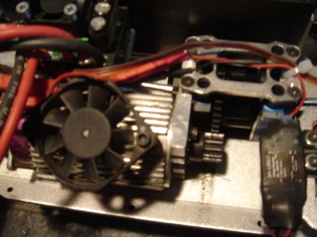

I wish those heatsinks had a built in place to mount a fan. That would make them even more perfect.

I wouldn't call it a built in place to mount a fan, but adapting a fan isn't too hard.
I got the 12v fan from radio shack and run it off of the 4S pack. I use a small 12v regulator, also from radio shack, when I run more than 4S. I just drilled and tapped the heatsink for 3mm screws. There's more than enough meat there for the threads.
That looks like it would work great. I did not think of doing it that way. I like it!

Yeah, I'm a drilling and tapping fool. I got a set of Dubro drills and taps and they cover all of the sizes that you need for RC. If you don't want to get the whole set, the 3mm screws common to RC are 3mm by .5mm pitch. I used the standoffs that held my mechanical brake pads in place and four 3mm washers. These fans move some air.
BTW, I'm also a soldering fool. Almost all of these fans that I've seen come with this little bitty 28 gauge wire. I have some leads that I made using 20 gauge silicon jacketed wire with jst plugs. I remove the stock wires from the fans and replace them with my leads. Just being anal, but I have had a few of the stock wires break.
