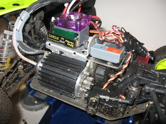

well i received the crt .5 today, pretty cool truck , any way i decided to try the novak motor, a little cogging ocasionally when off and back on throttle and sometimes when trying to go from a dead stop(very little) and i was geared 15/46(stock spur) and there was no heat at all after 10 hard minutes, so i am going up to a 16 tooth pinion and maybe more, but if i go to a 3s lipo will it get hot or just go faster ?? right now 20-25mph
anyway here it is thrown together quick for a test run and also pictured is the shop supervisor
this will get cleaned up and wires will be much shorter, i just had to drill one hole in the plexi for now and i can easily take it out and put it in the revo(the esc.)

oh and can i just cut the sensor wires?
will novak still take it back?

thanks guys, and i think she will get a micro-t for x-mas, i put in a 18 tooth pinion and will try today and see if it gets warm, i also need to adjust settings on the mm, i havent changed them and they are all pretty low,
any ideas on timing, punch, and start power?
thanks for any help, oh and i am running 2s for now

temps were still great @ 18/46
anyone have a suggestion on how to get rid of the cogging i get when i start(only when i go full throttle)
i tried to adjust different things and didnt seem to help much
seems to be faster now though, it will wheelie and such, probably about 27-30 id guess, goes good though the front tires balloon like crazy
i think a 3s pack would be perfect
