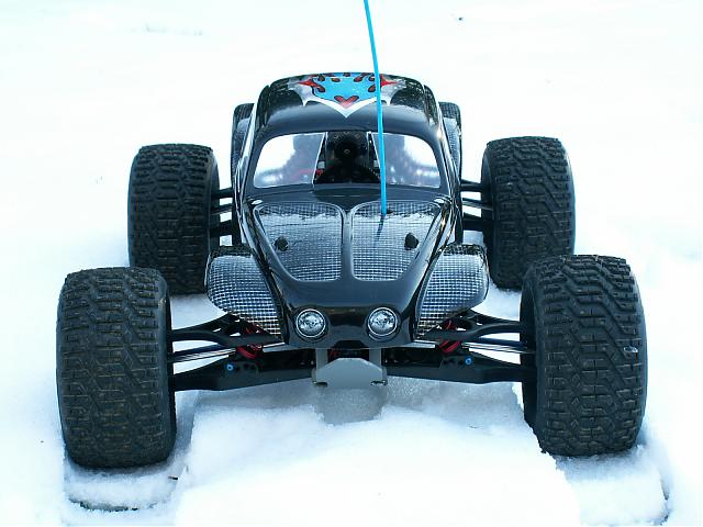

holy mahonny, How did you do that? that's impressive... any tips for me where to save more weight... I really dont know where else I can cut lol

Originally Posted by superlightmaxx View Post
Finally got some pics to share my ride with you guys! Feel free to comment..
Which motor mount are you using?

that's a gorillamaxx motor mount, not the current edition tough (they dont have those anymore on their site but you can still get them) I like the look and works pretty good for a LIGHT motor, if to heavy as with my 8xl it tends to spring to much... but can be fixed with a rear custom motor mount I guess.
I like that the weight distribution is really good with this mount BUT it's has a high center of gravity lol

I used two stock sliders in front, and two CVD's in the rear.
Titanium pillowballs also shave off a good 20g grams. That XL motor is lighter too.
I don't use 2 servo's and the gmaxx mount is heavier than the stock one. (and it's single speed)
titanium turnbuckles, 4 shocks instead of 8, no wheeliebar, no bulkhead braces and a light stock body.
I think that all puts it together for a lighter truck..

My chassis was probably the older version; the xbraces are lighter, skids where 17% lighter and all the carbon was 17% lighter too.
11.25.2007, 12:19 PM
would the slipperential make it lighter than the single speed? and is there a way i could get a old gmaxx cf chassis and the v1 slipperential?

Serum, I see you know your stuff a lot... can't get anything past you, hehe. I do have al. pivot balls and al. turnbuckles, the wheeliebar is only on when I run on the street and not counted in my weight. I know the xl is 60g lighter but i'm happy with my 8l for the moment... that xl is sure more expensive... On your truck you mover the tranny forward, how did you acheive that? did you make custom dogbones? how was your weight distribution? mine is really close to 50/50 front and back, I only have about 100g more in the back.

No, it's simple done by flipping the transmission, since the singlespeed uses the same output shaft as the stock two speed gearbox you can simple turn it around. (you can do this too, it doesn't require other shafts)
You can shift the weight balance with batteries rather easy. If the pack is thin enough to slip below the servo horn you can go any way you like it.

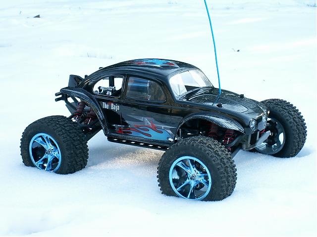

here are some pics with my regular maxx sized bash tires. For those who dont like the look of skinny tires. hehe
