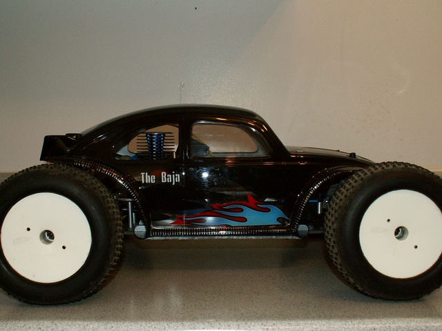

PICS of my GORILLA T-MAXX... - 01.21.2008, 03:56 PM

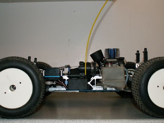

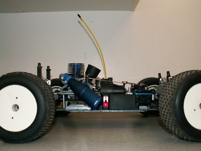

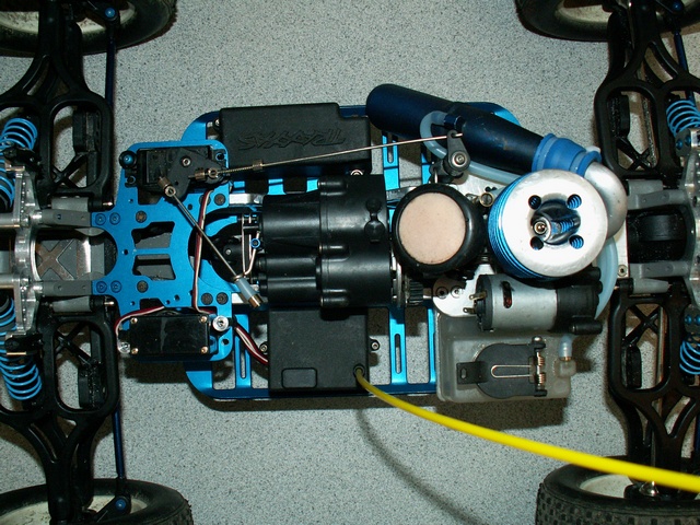

first version!
Still some work to be done!
Will post more pics when finished!

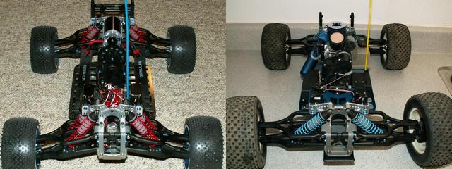

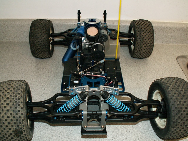

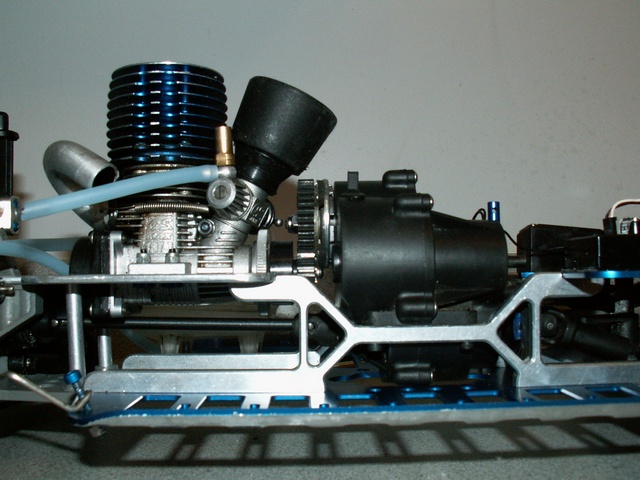

Here is the rest!

01.21.2008, 04:17 PM
That awesome! The fact that the engine is perfectly center should make for an amazing weight distribution.
Let us know how she runs (actually - get a vid to show us!)

01.21.2008, 05:32 PM
Thanks BP-Revo! once I remove the ez-start the weight distribution is going to be pretty much taken care of :O) And I like the fact that the weight distribution is very similar with my brushless Gorilla E-maxx as both engine/ motor position and weight are almost the same. See pics to compare

01.21.2008, 05:47 PM
By the way this rig is 3500g (7.7lbs) without rx batt and fuel so it's much lighter than truggies so i'm pretty impressed with the weight saving so far! when I remove the ez-start and reverse gears it will be 3300g (7.25lbs) with an OS18TM so watch out truggies!!! just kidding about truggies... well maybe not! hehehe

entjoles
01.21.2008, 06:21 PM
wow, looks great
btw...it looks like the exhaust stinger is pointing down, if you land on soft dirt it will plug the stinger and flood the engine
superlightmaxx
superlightmaxx's Avatar
Posts: 118
01.21.2008, 06:50 PM
your right, great eyes! I didn't secure the pipe yet as I'm still waiting for my exhaust seal that needs replacing!

Another 1st for RCM. I wonder if George fro GorillaMaxx has seen this, might inspire hime to make a dedicated Nitro chassis. It does look rather cool like the dead center engine.

01.21.2008, 10:22 PM
does that have the revo center diff?
  Send a message via AIM to ib4200
superlightmaxx
Posts: 118
01.21.2008, 11:14 PM
No it's the t-maxx tranny but I do have a revo tranny and it could mount in there with slight modifications (spacers and shaving 1-2mm off the brake on each side). My revo tranny doesn't have the diff and is missing the output gear so I just re-used the t-maxx one and just shaved a nick on one side to be able to mount it lower :O)

01.21.2008, 11:16 PM
Is that an HPI Bug body or the Proline unit that was discontinued?
:D
superlightmaxx
Posts: 118
01.21.2008, 11:47 PM
Proline for revo 3.3 as my gorillamaxx chassis is extended (wheelbase 13.7") and yes I think it's discontinued! Should I save it from scratches... lol
