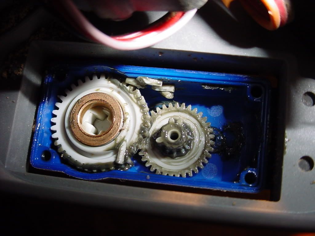

Well I finally got a chance to run my E maxx again. Got a few jumps in, ran around a little bit and the steering started acting erratic. It acted like the steering was binding. Sometimes it would turn and sometimes it wouldn't.
I disconnected the servo's and checked the steering linkage. Nothing is binding, it's turns VERY freely.
Looks like these "Water proof" servo's are NOT really all that tough. Anyone got any suggestions on some tough ones? I think both of these just stripped out. They don't have to be super strong, just tough, since there will be two of them serving the purpose.
I have a CC BEC set to 6.0 volts, but I didn't think that should hurt them like this.

I use the cheezemaster-deluxe MG995 servos. Haven't beat them up that much, but others report having good luck with them. Dang powerful (you'll only need one) and at <$20 you can afford to blow through a few.
Serum
Serum's Avatar
Posts: 10,480
01.31.2008, 01:38 PM
Looks like you simple trashed the S out of it.. :)
The 995's are pretty tough servo's indeed!
