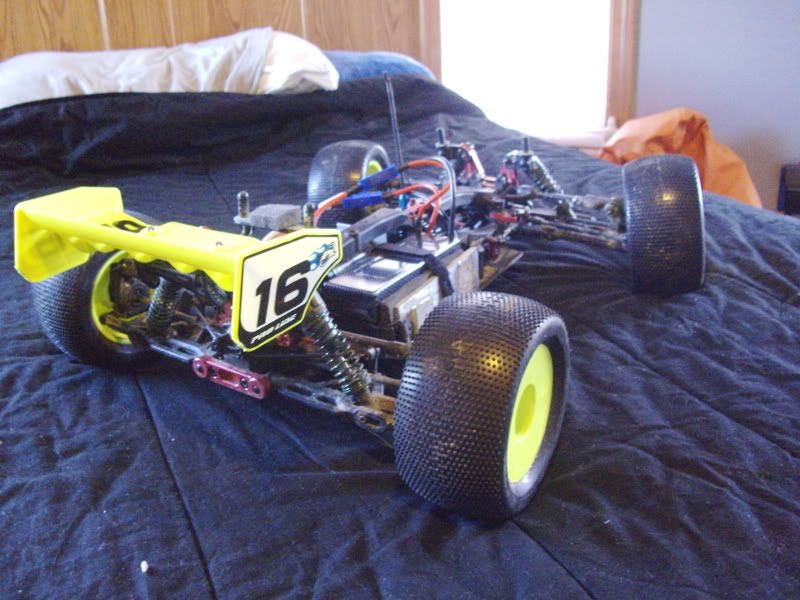

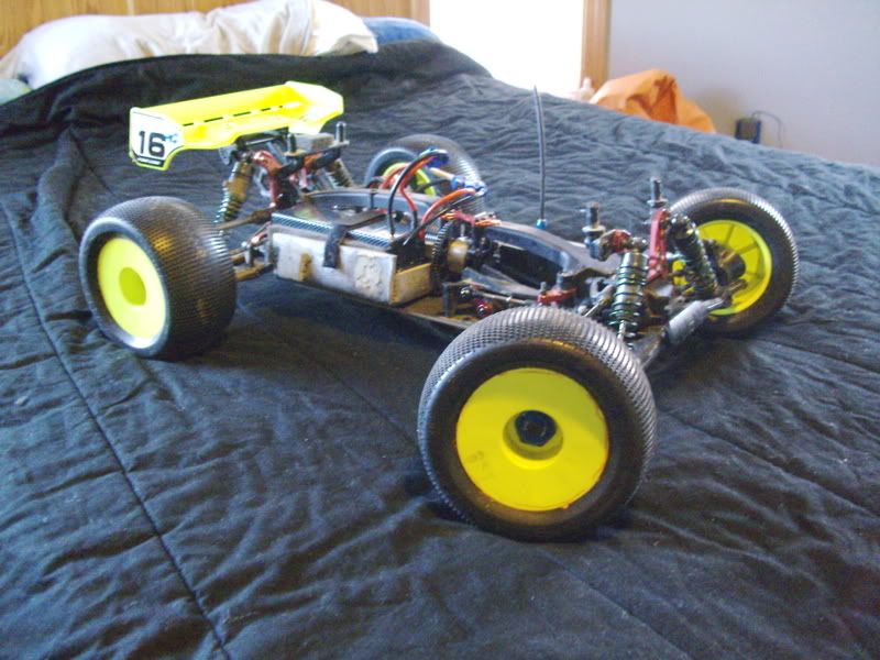

very nice ben!!

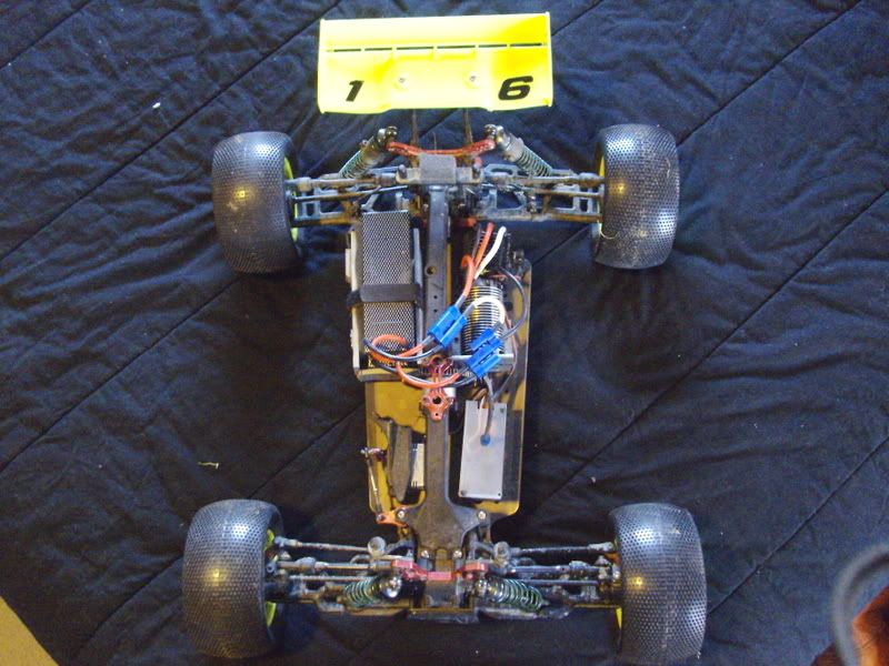

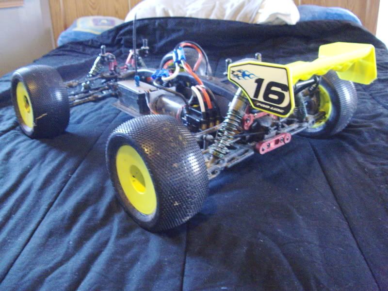

Thanks trev.. also got a new wing! makes the truck look pretty:)

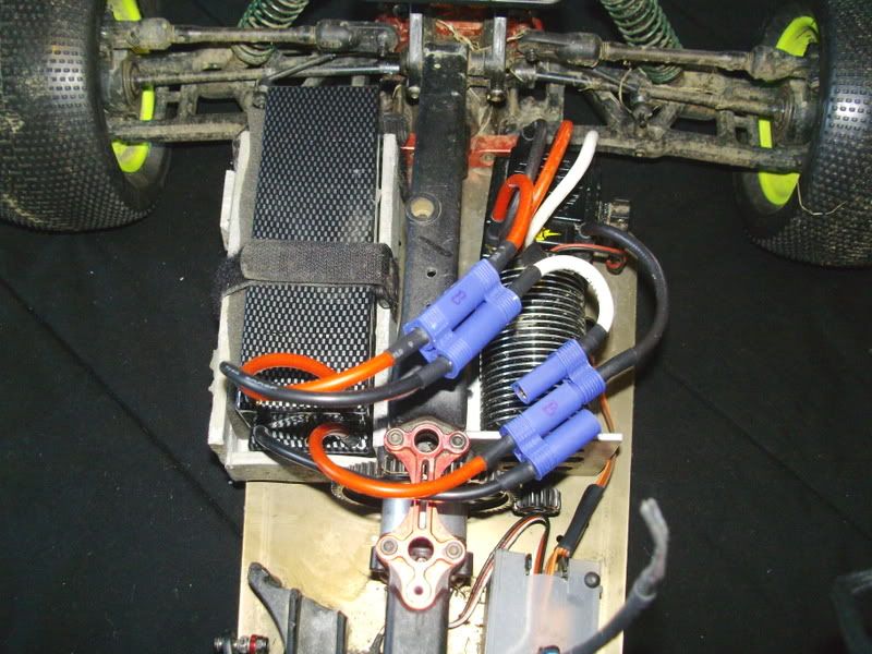

One quirk i have found with the RCM 2s's is the not-so-standard thunderpower balance tap, I ended up taking the indidual connectors our of the TP housing and pluging them into my charger/balancer manually..

Those are some nice looking lipos...

Looks great.

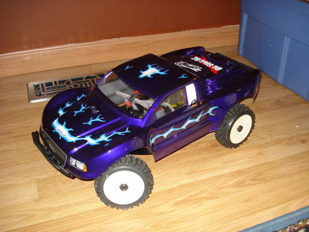

I just thought that I would share my Cen Matrix Buggy conversion (not fancy), but I did read someone (Brushlessboy) here thinking of what CORR Hybrid look would do to it...so here are some PICS.

wow that looks really good! But i have the truggy ;) Where'd you get those piggyback shock caps from?

The caps were the caps from the CEN GENESIS, and a hardware kit. I got the numbers from CEN SUPPORT. I do not still have the email from them as reference. (I should keep that stuff)

Were they a direct fit for the matrix?

Yes. It was direct, and easy. As a bonus even the plastic was the same color. Makes it look factory.
I found the part numbers:
Resivoir: (2) GS233
Small Parts: (1) GS065

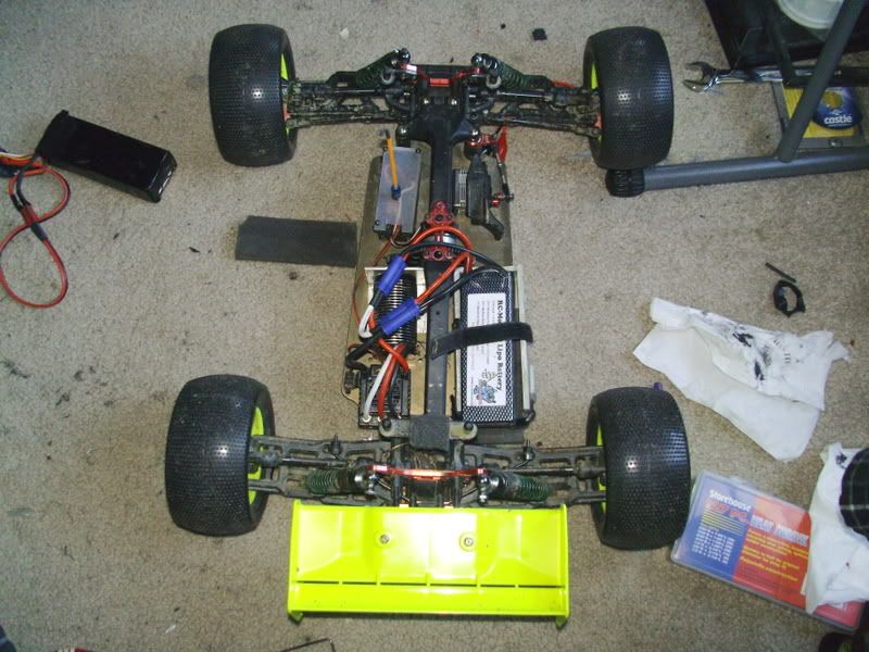

Nice tires Ben, the wing looks good to, I got hole shots on my revo.
01.05.2009, 10:15 AM
Looking good dude. Why not set up the truck for saddle packs?
brushlessboy16
brushlessboy16's Avatar
01.05.2009, 01:12 PM
I plan to set up for saddles. I ordered a smaller spur so I can flip the diff and put the motor up front-across from the servo. I have a second set of the losi Trays on the way (the flat bottomed onefits but the other does not) so when all the stuff arrives it will be saddled. I just need to find a place to put the Bigass MMM now...
