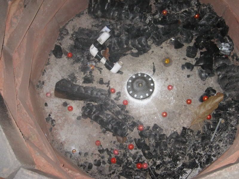

My Bomb shelter / fire pit I test all my stuff in.. LOL.LOL
After it’s first explosion.

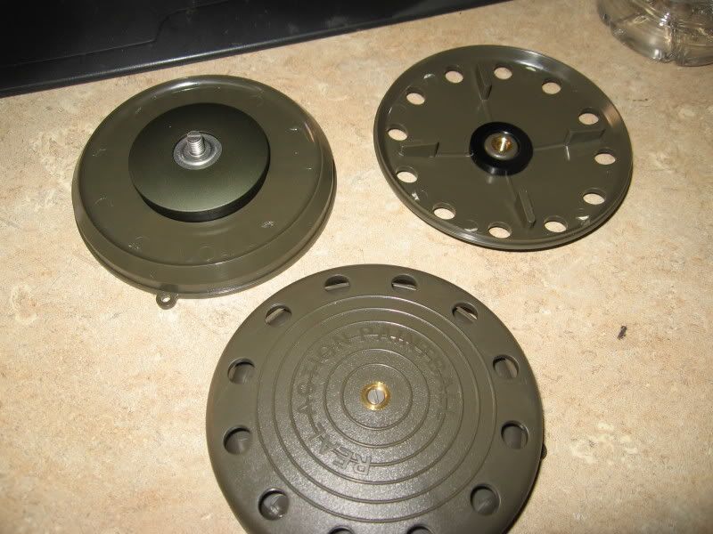

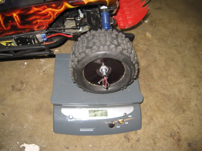

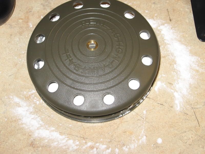

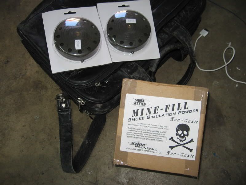

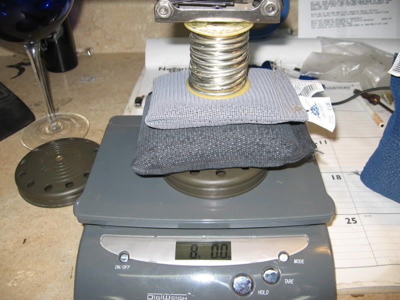

They lied!!! These don’t engage at 3lbs as clearly stated in the product description! (bastards), they fire off at 8lbs. This is a big problem especially since I only put out 5lbs per wheel now.. OOoo well it’s nothing some lead weights on the inside of the rims wont solve. The pisser is, I’ll have to add a total of 12 lbs to the tires (front and rear) every time I use the land mines!.. That sucks.. / or IE it’s not worth spending $120+ plus for a landmines.. (FYI) Don’t Do IT!! please learn from my mistake!..

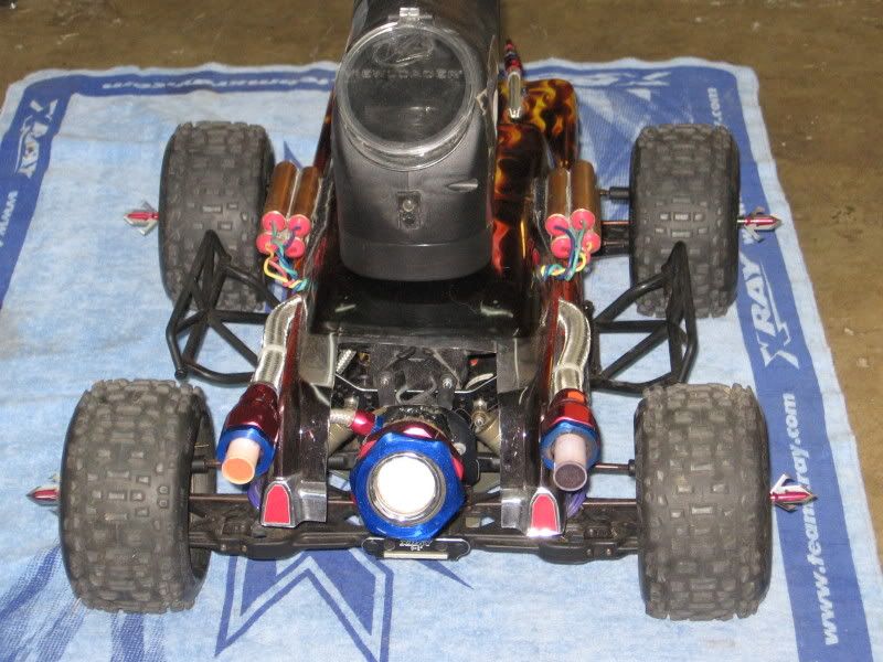

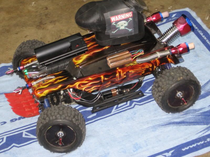

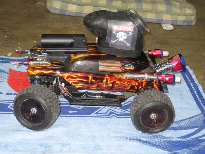

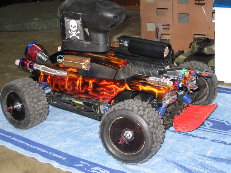

SSOOOOOoooooo after consuming large amount of alcohol tonight I was able to gain the confidence required to cut up my body to accommodate for the grenade launcher and please note!! I still have the skull eyes glowing HHooo, HHHoooo, HHhhooooo.. WHO’S THE MAN!!!
And I finally got my shocks all worked out! (What a huge pain in the A$$), after trying several combinations, I finally ended up with this one:
Front:
Original XT8 rear shocks with 2 springs (front XT8 & rear XT8 Blue) and 5/8” of spacers. Believe it or not this combo works great with the weight! And still gives me plenty of suspension clearance.
Rear:
808 rear shocks. Purple springs, with the spring cup tightened all the way down and using ¼” spacers. Again, this combination gave me the best results.
Builders Note: (PLEASE!!!)
Never attempt to run this shock setup on your Truggy!! It’s SSsoooooo wrong it’s pathetic!! But for my needs it works great!..
I was able to repair my rear smoke system, got to love JB weld!.. LOL.LOL
And I also completed up the wiring (again) for my rockets (wish me luck!) This has not gone well!! But I'm feeling like maybe tomorrow is my DAY!! (Hay!, I can dream cant I) LOL.LOL

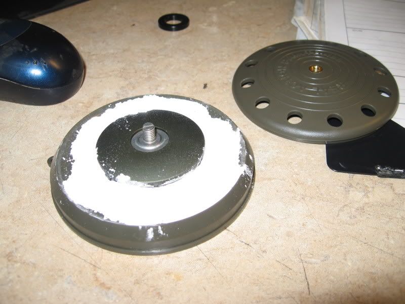

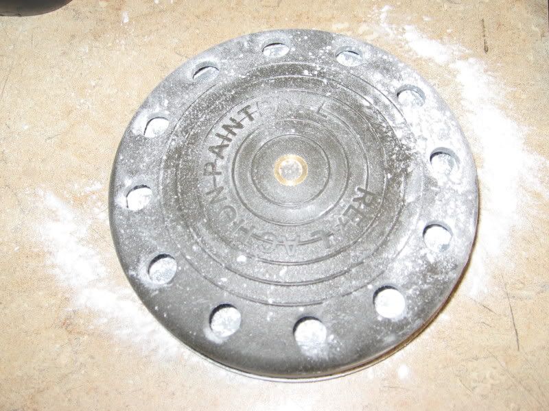

OOhhhhOOo.. FYI… The Landmines (SUCK!!!).. I’ll use them because I paid for them, but DO NOT BUY THEM!!! At least for your RC props.. Paintball there cool, but for what I had hoped, versioned (they suck!) .. I’ll be more than happy to sell them to you after the town scene is completed..

I think I got the land mines worked out (?) further testing still needs to be completed. However the rear net is going NO WHERE FAST!!!! I’ve got some great failed video I should post of disappointments and unforeseen mishaps (IE) I now owe my neighbor a new side window (long story).. got to love the RD phase!!!
