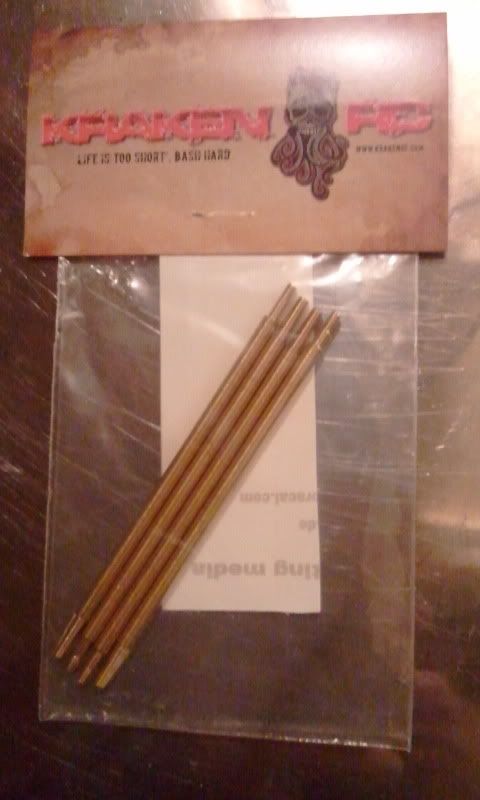

I received my new REAL TITANIUM Suspension shafts from Rob at KrakenRC!
http://www.krakenrc.com/index.php/pr...ucts/view/2/10
These look awesome, and are extremely tough. Definitely tougher than stock from what i have felt, and for people that stilll bend the Alloy BigBore Shock TI COATED Steel shafts, you know what to upgrade too now :)

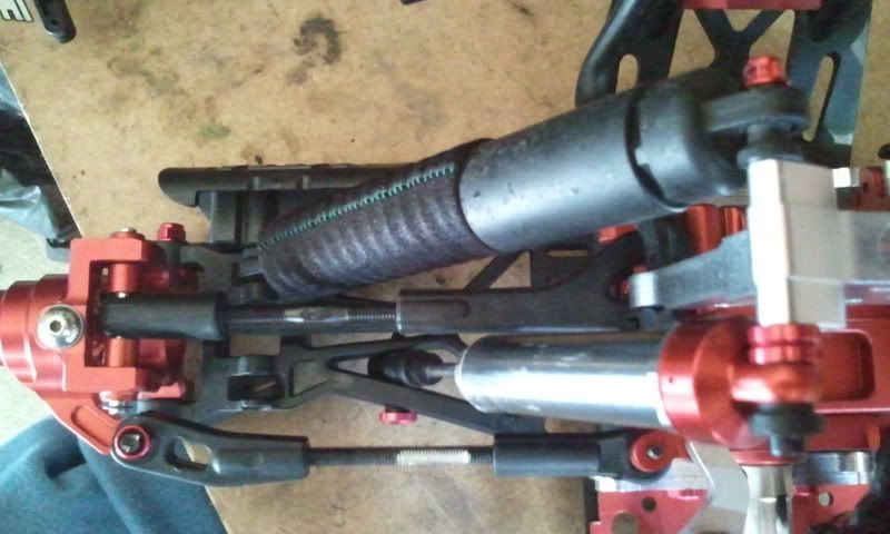

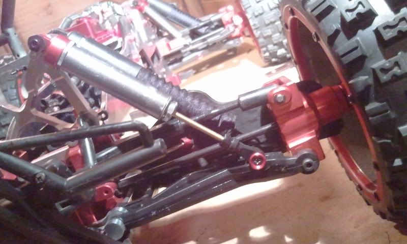

Some nice pics installed showing i still get great travel with my shocks.
Rear Shock
Front Shock - ------- Note it isnt installed in usual lower a arm location!------ info below as to why...
WHY HAVE I MOVED THE FRONT SHOCK and Removed the sway bar? Because i wouldnt get full steering throw without so.
Only the front sway bar has been removed. I will have to see how it handles without it. Im hoping the large offset hexs will save me here.... Only time will tell.
Where the Shock Is now sitting on the lower a arm (sway bar location) Notice the Shock with the black sock using the original fitment position.

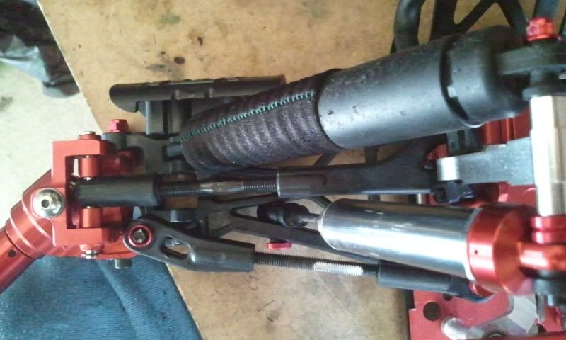

Steering at full throw. You can see how the steering rod end connecting to the spindle, requires the space where the shock end would be fitted to reach its full throw.
So now i have moved everything, and i am getting full throw... I should have great steering

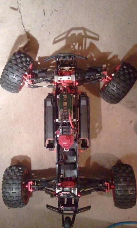

Little teaser pic of the cage finished...
Should be running in the next couple of days :twisted: Just need to get my brake problem sorted...
