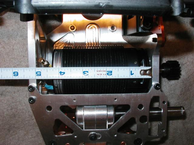

Mike - Can you confirm that there is 5 inches (127mm) of space for a motor?
  (#317)
Electric Eel
06.19.2010, 09:36 AM
Here's a picture. 5 inches exactly.

Thanks so much for this!
  (#319)
billy gunn
06.19.2010, 11:05 AM
From that pic, a 2230 would fit. It may be tight with the wires though. Once Mike gets some more kits in stock, I'll let you know. I'll pick one up for my e-baja

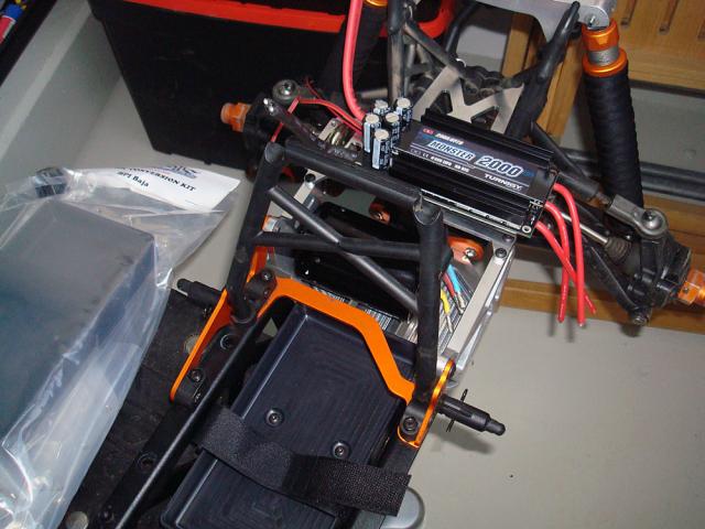

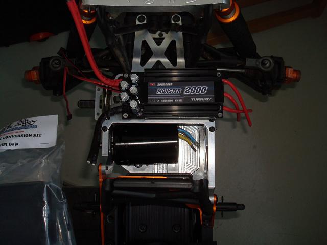

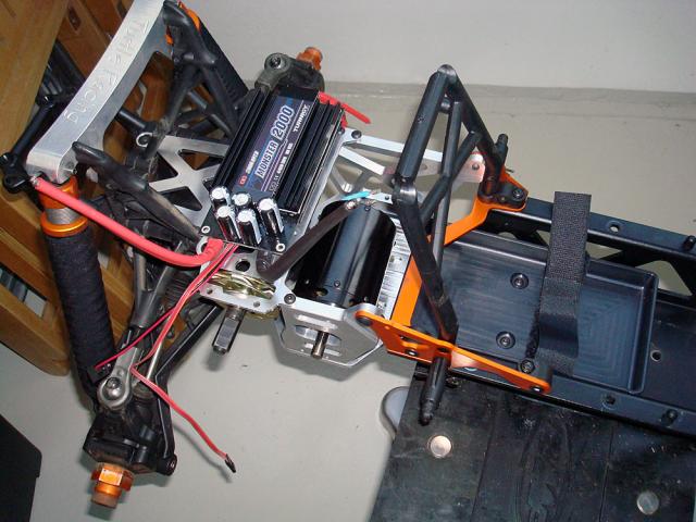

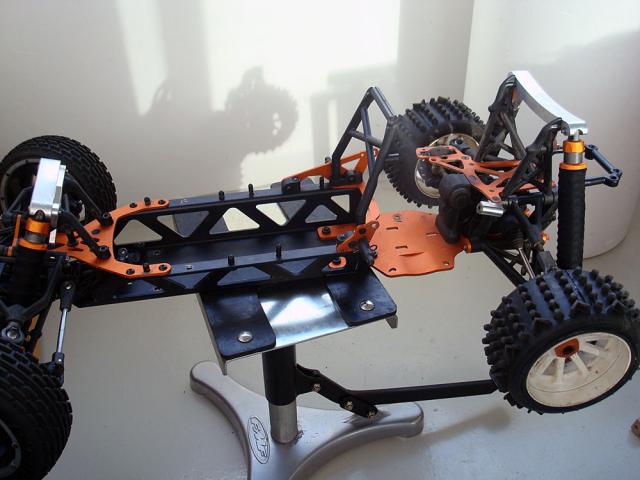

Kits finally arrived - 06.22.2010, 04:16 PM
The (first) wait is over. I finally got the kits and mounted the first one. I only had little time to do this so I am by no means done. Still missing the batteries (10S config) which unfortunately are out of stock.
Anyway - for this test setup I have the Turnigy ESC, the Castle BEC, 10S batteries, 2215 Neu 750kv, pistix and 13T pinion which will give me a speed of around 64km/h (40mph). This is a test setup and I bought this fairly cheap ESC to test how it works while I wait for the Castle ICE ESC for cars (should be able to handle 12S/160A according to Patrick from Castle).
I am also going to build yet another Baja where I will test a Neu 2230 and a Lehner 3060 but only when the new Castle ESC is out.
Excellent kit btw Mike - mounting it was a pleasant experience. Great fitting and workmanship!
