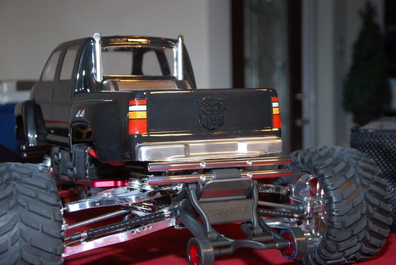

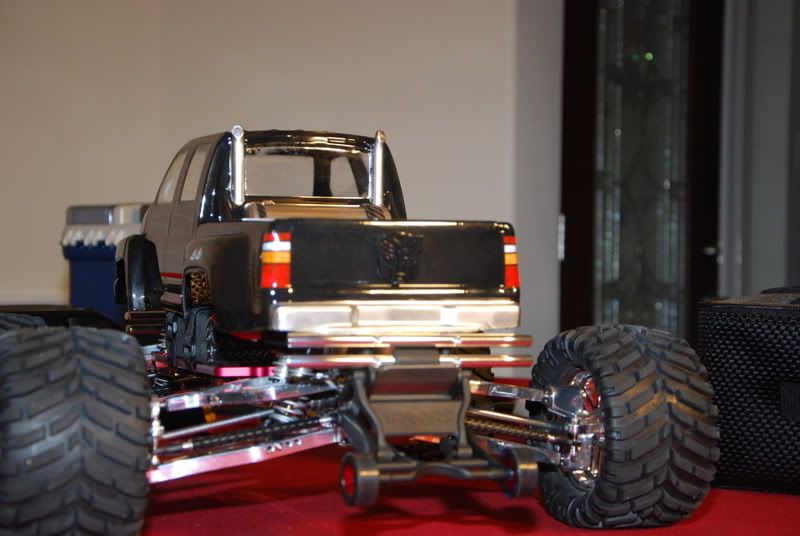

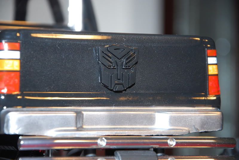

No MiRatlhed,
I don't own a Savage. I only have the Emaxx with the two Topkick bodies. I did put a Transformer emblem on the back of the black topkick.
