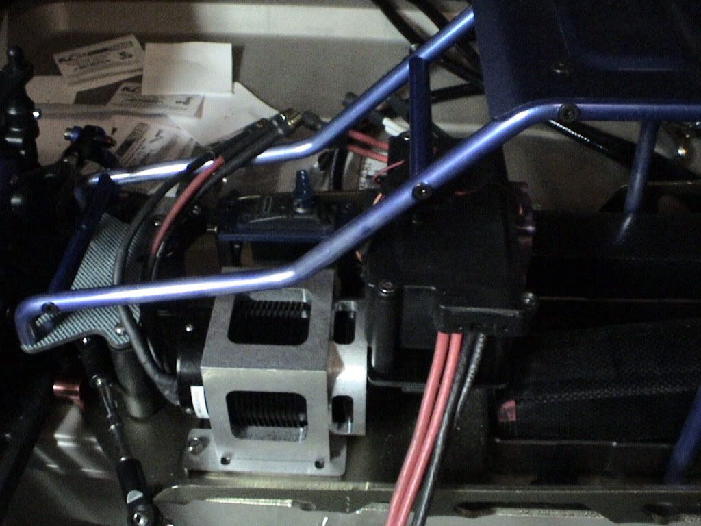

thanks all. the vid is great thanks to kulangflow and the truck has been fun. here is my new body since my first got destroyed. the new body makes it look much larger. i took it to the park yesterday and shredded! it was a blast. hauling across the grass on two wheels half the time. i did an end-over-end flip about 30 ft coming off of a grass hill jump. kept on trucking. one problem though. i checked temps when done and motor was 170* and esc was 110*. esc is fine obviously but that motor temp was totally unexpected and in the danger zone. everything is fine but i like to keep things at 150* or less. i thought i was safe since i had been checking temps every five minutes the first few days of running and never saw it get hot once. i was really running it hard but what do you guys think caused it? geared to high? geared to low? i have a 17t and 18t pinion i could try. should i try those and go higher? based on esc temps isnt it most likely geared too low? and actually i dont know how hot the esc was. by the time i got to it to check it was only like 80* but had the fan on it and the motor had cooled 30* in the time period to get to the esc so i am just guessing the esc was about 110*. it could have been cooler.

IF gearing is producing the torque/speed you want, then it's time to reconsider your motor mount. The motor mount, while open, is still thick. I don't think you have one-quarter of the fan that motor needs... and the mount may be acting as an insulator more than a heatsink. You have enough of a hole to use a larger fan, and I would consider one on either side (if you have the room) blowing inward, so that the top is just an exhaust. The fins can't do their job in a semi-enclosed mount like that IMO.
If you have to make more relief for air around the inside, it won't show. But it could be a big help.
Or just wait for colder weather lol... won't be long!
